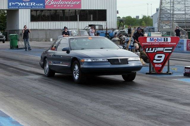

LOL you would be set up like the old school gassers.
But thank God we have IRS with Air Bags. In the Old days drag racers would give there left nut for the way we launch stock.

My car is stock, and it doesnt launch like that...

The shot with the stock wheels, the only mods at that time were 3.73's and that's it. Stock Michelen rubber too.
Sit at shoulder heaight and take a shot of your car launching. All Marks stand up and squat.

The stock air suspension and IRS are great for launching at the track, much better than other stock cars.
JP I noticed you appeared to be lowered.
Walt and I did about 25 experiments with launching these cars and found that we had the best results with the air suspension at FULL height to allow for maximim SLAM on the rear wheels.
We got our best 60ft times with this method.

Hell yes G, all them squat, heck we even squat when we downshift...ever have a mark pullin on ya in your rear view mirror...you can see it look like its ridin a foot too high.
