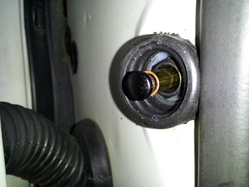

Mine was doing the same thing but the problem for me was the door jamb switch. It's a simple fix, IF that's your problem. rockauto has original Motorcraft switches and one to your door is just under $9.00 and takes every bit of 2 minutes or less to swap out. Just a thought for you and cheap enough to try.

The door ajar indicator is unrelated. It's another switch. Door ajar messages are controlled by a switch in the door latch.
Do the interior lights come on when you open the door? That is controlled by that door jamb switch. If the interior lights turn on and off normally, the door jamb switch, no limits picture, is prolly fine.

My interior lights were coming on randomly, not often but it did happen a few times and then when it got real bad, I could open the door and the stereo and everything would still remain on. I started messing with the door jamb switch and pushing it in and out a few times and then pushed it in and would let it snap back out fast. Well, I done that little fix too many times and the part of the switch that slides ended popping out in the floor and I had two pieces. If I tried putting the button back in and pressed in, the lights would come on lol. I just left it out and ordered one and replaced it with a new one and no problems since.
I went ahead and ordered another one for the passengers side just so they wouldn't be messing with me anymore. Mine did for sure let me know that something was wrong though when I opened the door and the message center was still on and the stereo. I knew whatever was making my interior lights come on while the car was off had gotten worse and it was that one switch. Seems like it was $8.56 to the door from rockauto and I had it in 2 days. It comes in a box that is 30 times too big for the little switch box.
