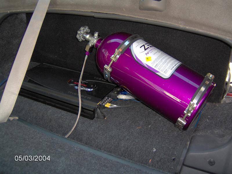

I'm more intersted in which ZEX unit you used? I've used a ZEX kit on my V8SHO running 13.8's, but it was a dry system. From what I've heard hooking up nitrous is a little more difficult on the LS due to the FPR (Fuel Pressure Regulator).
Do you have any pictures of the placement of the ZEX control unit placement and hoses?

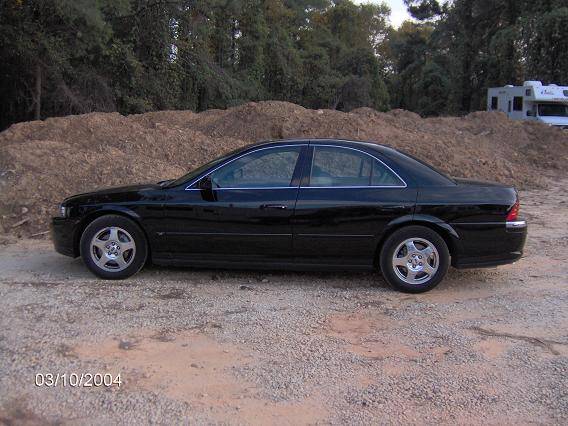

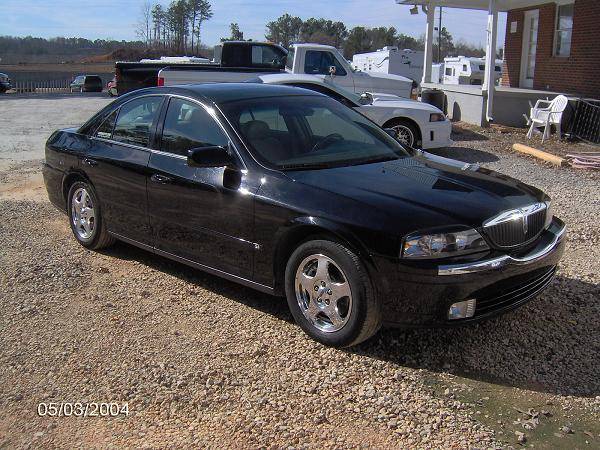

Nice LS, some black on crome LSE grill would look nice, and maybe some black center chrome 20s. I love those W7s, that's one bad mother :q:q:q:qer.
Wheels and tint definately. Get some good wax for that thing too. Sharp looking car, I like it alot.

Its super easy on this car to hook up a wet kit.....I took the fuel shrader valve out put in the fitting that comes with the kit and screwed on my steel braided fuel line.....

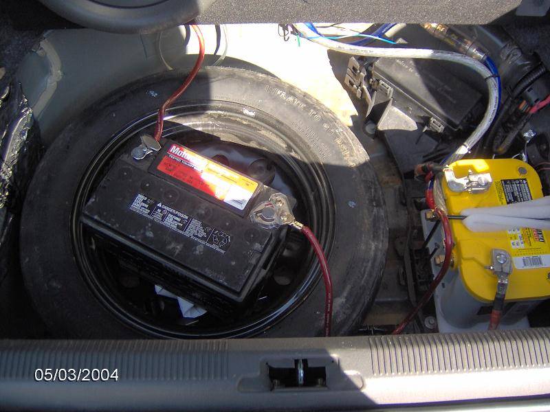

Dude, vent those batteries!! I'd hate to see you, or that pretty LS, go BOOM!!!!!
Nitrous Bottles have a "burst" disc that will "blow off" at around 3,000 PSI this will keep the bottle from blowing up......There was a guy that blow his car and garage up because he painted the bottle and valve.... making the burst disc no good.......
I hate DRY kits you need to up the fuel and that is not easy on this car.....
Stick with the wet kit......
