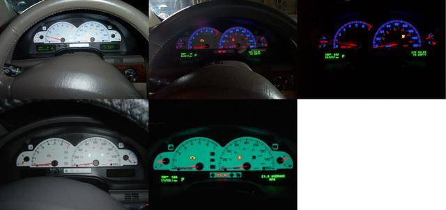

i like these ones (the 3 pics on the top are the same ones)...
The first set are the ones I want!!! Where do I get 'em???? Tell Me!!!! Just messing, I do want 'em though.

It isn't difficult as much as it takes some time. You will have to looosen the steering column to get the instrument cluster out.

It's a pretty in depth operation.
You have to pull the panel under your steering column, drop down your column, remove your cluster(being very careful) then you have to remove the plastic cover, carefully place the needles in a 90 degree angle, then VERY carefully slide the new guages on over the needles(while trying not to sweat to much being afraid of breaking a needle) then replace all parts and if done right your needles will recalibrate themselves with no problems. If you have patients and a little electrical knowledge its an ok job to do.
installation shouldnt be that hard, I pulled apart my gauges just to clean a damn dirty spot inside that bothered me :D, im thinking of getting some gauges my self..
