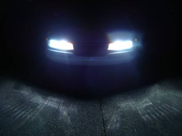

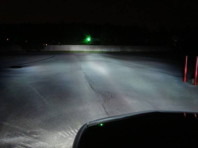

Sometimes the aim can get off when they're removed but you'll just have to test them and see. Mine have 4 HID 6000K bulbs and usually have to be aimed again if they're pulled out for any reason.

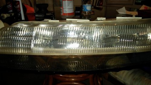

I was aiming them here in this pic.
Ah, gotcha. I'll have to check them out after I put them in.

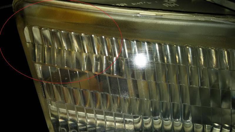

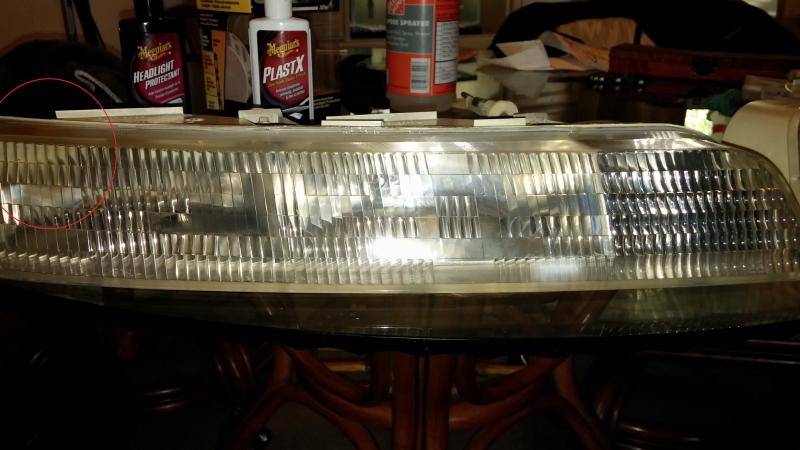

So mad at myself. I was blow drying and I think I held it in one spot for just a few seconds too long. Passenger side now has a slight yellowish burnt look to one corner and I'm almost positive it wasn't there before. I think I burnt the inside chrome when I was doing it.
It's normal for a lot of older housings to have yellowing on the backside grey area. I doubt you done it with the blow dryer but I guess it's possible.
seems unlikely, but yeah maybe.

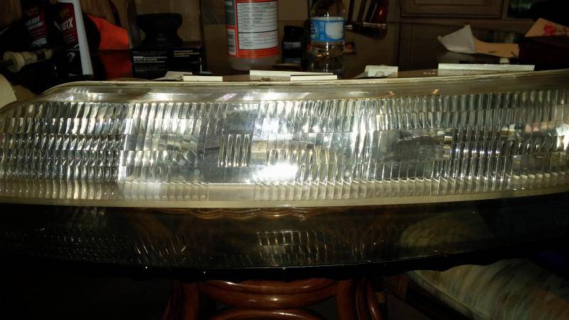

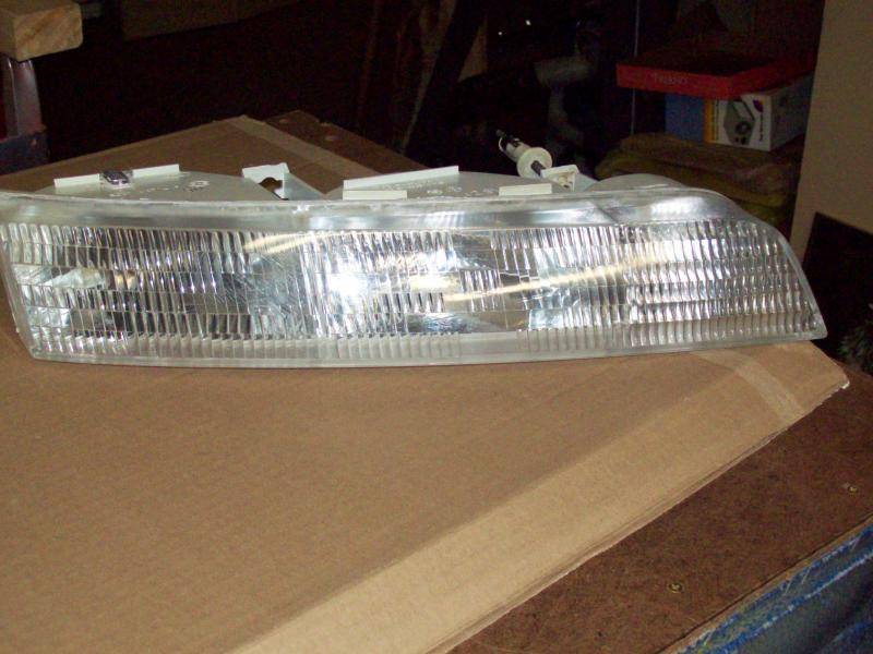

let me dig out my really bad housings...

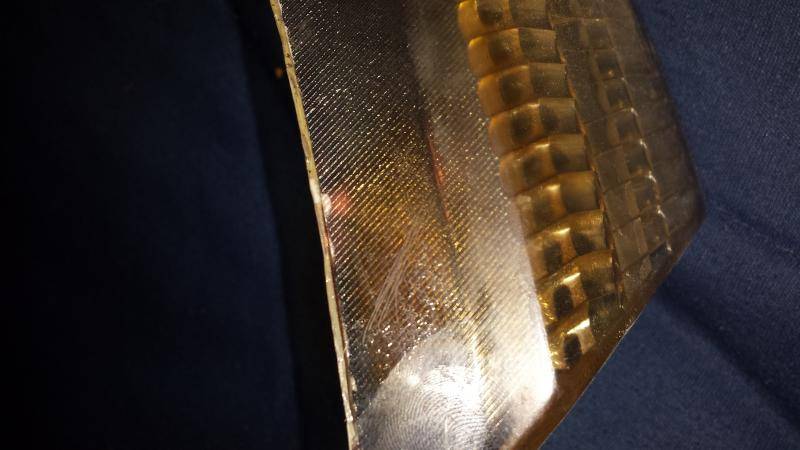

Here is what I'm talking about on mine...
I circled the little area. I could be wrong but I could have sworn that wasn't there before I pulled out the blow dryer. On the driver side, I use it for a fraction of the time just to be safe. While I had them out, I decided to buff them again with PlastX and apply the headlight protection. Flash went off on all the pictures and it seems like they still have good reflective material in them so that's good.

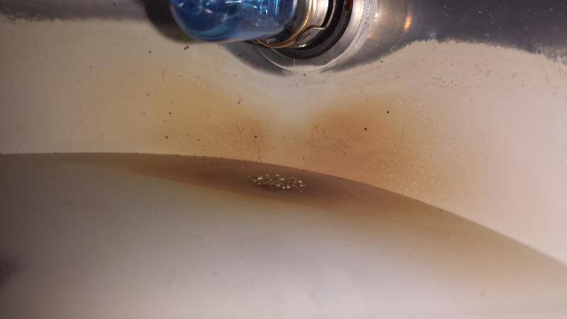

you didnt do that. that's long term exposure to the headlight heat and uv rays. mine old set has the same brown spots.
GEN 1 HDLT 2.jpgWhat Chris said about heat. You didn't do it with hair dryer. I tried mounting a heat sink right above the base of low beam bulb. (chrome piece on top of housing) Hooked up on bench heat got to 154 degrees at the heat sink which is about 1/4" above base of the bulb, in 15 min. The lense got pretty hot also. A little wind from a muffin fan cooled everything down quickly. If the car isn't moving the lights will get very hot.
