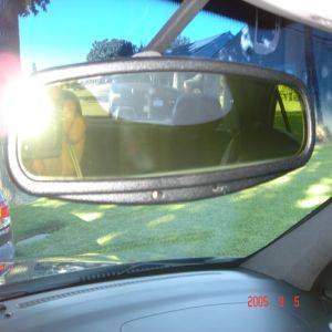

WHAT happened to my rear view mirror?? HELP!!

Any suggestions?
that an auto dim right
that stuff just happens some times
nothing you can realy do to it other then replace it from what i know
yep, happened to mine bout 4 months ago. the oil in it that cause it to dim leaks out of it and no longer works. your best bet would be to find one on ebay

The problem with the ebay ones is they are used and their longevity is unknown. The problem with not replacing it is the chemical inside can leak out and leave a permanent mess on the dash.
