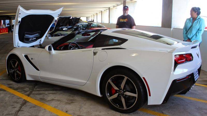

I dont have many options. Its either the painted aluminum or aluminum. Im not sure how the "brushed aluminum", or I guess they are calling it "machined aluminum wheels" are done. Im not sure how they get that look. I like those best and the grinding and polishing the aluminum wheels i posted above could give me that same look for a fraction of the cost.. Heres some "Machined face aluminum wheels" on a vette.

for machined wheels, they just clear coat them right after they get machined or milled, that look, is directly from the tooling that cuts the metal into the shape.
I see. So its called "machined". Hmmmm....i dont know what im gonna do now. Im not crazy about painted wheels
