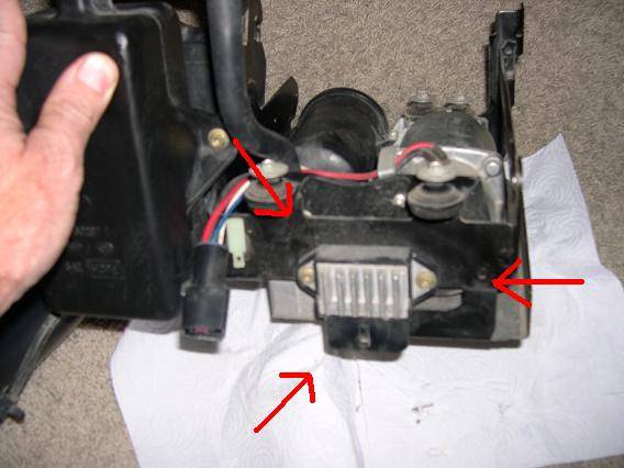

This is my suspension compressor. What is the big computer-looking thing on the side? Any help would be greatly appreciated.
The control module is located inside the car not on the outside. All years the control module for the suspension is located behind the passenger side kick panel/glove box.
That part is the Variable Load Control Module. What it does is communicates with the PCM (powertrain control module) thru the mulitplex communication network and it incorporates the circuit control provisions for the fan motor and the A/C clutch field coil.
:Beer
So I guess I still need this after I convert to coils, huh?
I would have to say yes, unless you do not want your heat or A/C to work correctly..... :N

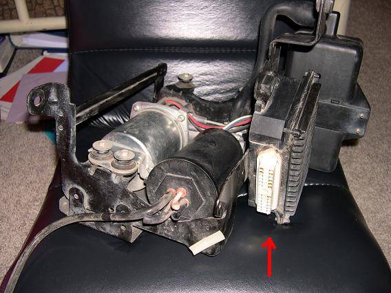

is the relay pictured in that image too?
No. Here's a pic of the relay. It's on the opposite side from the first pic above.
