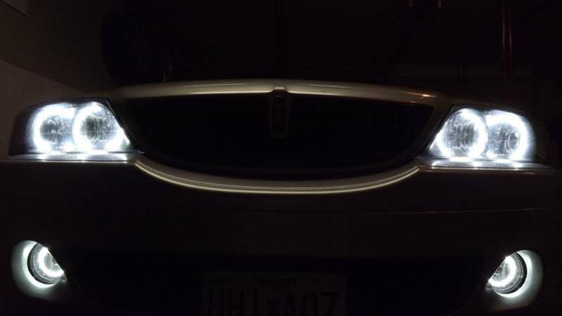

The CFL's require a ballast. LEDs dont. The harness needs to be wired in to whatever power source you are using. With the harness, you can easilly disconnect the entire headlight assembly without cutting the wire to the halos. I wired mine to a 12v switched source and a toggle.
Wow, great price. Will they fit my gen 1?
Yes, mine is a gen 1. I ordered the 125mm rings. And 80mm for my fogs (I have the round fogs obviously)
