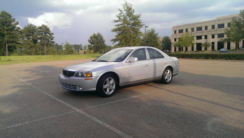

It looks like the previous owner put those aftermarket chrome strips on the rocker panels and the door pillars. I don't absolutely hate it, but I wouldn't have done this given the choice. The biggest thing that bothers me is that the lines don't flow because the chrome doesn't continue around the bumpers.
I'm considering two very different options:
1. Remove it all. Biggest concern here is getting it all of cleanly. What adhesive is usually used on these? Should the old fishing line and Goo-Gone routine work here?
2. "Chrome" the rest of it. I searched on eBay but didn't find anyone selling these chrome pieces pre cut for the bottom lips of the bumpers. Is such a thing available?

If you lived in a more snow prone area, I might be afraid they could hide rust but otherwise...is the area covered normally black? Can't tell from the picture.
No snow. I live in Mississippi and until this week, the car has spent its entire life in Florida.
The door pillars would be black normally, and the rocker panels would be body color (silver).
