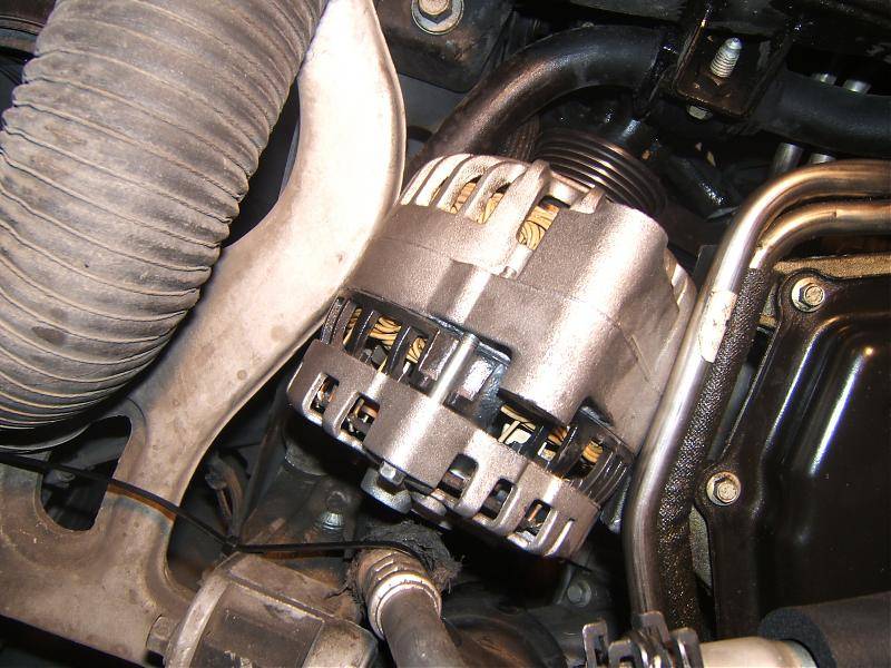

Getting the alternator turned properly so it will slide out of the opening takes a bit of work… just keep trying and use this picture to orientate the unit.
I believe all you need is a wrench and socket with a long extension (either 13mm or 15mm) to undo all three bolts.
you need to use a 3/8" breaker bar to release the tensioner pulley to get the belt slack.
u may need a long flathead to push the "sleeves" that the bolts are in, back/out of the way. I actually tried this job once, and had all three bolts removed..and the alternator would not budge. Actually drove it about 9 miles to the Ford dealership with no bolts..and it stayed in. lol. Mechanic said the "sleeve" (for lack of better word) needed to be pushed back a bit.
