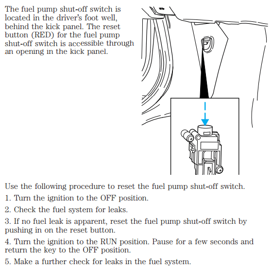

Hi everyone. What would cause my 2001 LS to disengage the fuel pump after sitting in garage overnight? This has happened three times now. The first (mid summer) time, I check relays and diodes before finally changing the fuel pump which fixed it. The second time (4-5 months later/late fall) I changed fuel filter and then the pump again (thinking prior was defective) which fixed again. Third time (month later/winter) I flipped relays and fuses around and finally determined that the common link was having the battery disconnected long enough to reset something which after 2h did the trick. I'm guessing there's something triggering one of the fuel shut-off mechanisms but not sure how to diagnose or repair. PLEASE HELP!

the fuel shut off switch wouldn't reset itself after the batter being off for awhile, you would need to manually reset it.
But the switch can fail. Mine failed, but in the "delivery" mode. No matter how hard I whacked the switch it wouldn't trip. A new one solved the problem.
Didn't say it was the problem, suggested to double check it, including the fuse and relay, corrosion is a terrible thing!
that failure also wouldn't be explained or cured by having the power disconnected...
