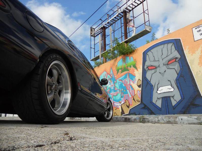

I'm currently running this on my factory Mark VIII (Octi-star, 7.5", 108x5 (5x4.25), 16", 39mm offset)wheels
-Kumho Ecsta Supra
-255/50/ZR16

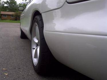

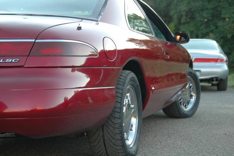

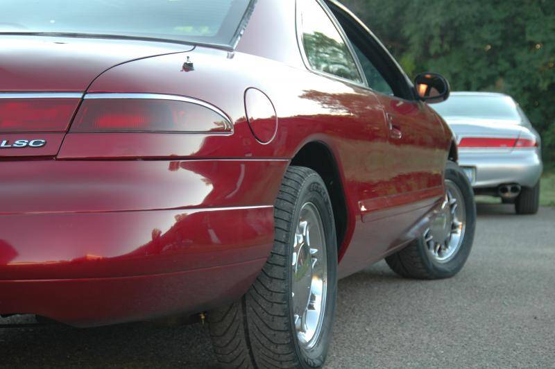

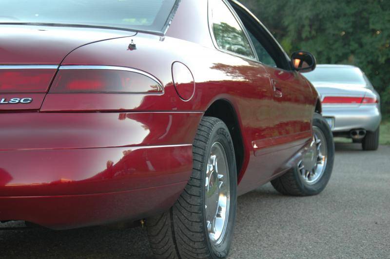

I ran P245/50R16's on the '96 and '97 with stock snowflakes on the '96 and chrome 10-spokes on the '97 LSC. They were pretty wide. And looked and handled great. I'm now running P225/60R16 stock width tires. They ride better and the speedo is spot-on perfect. But the handling isn't as crisp.

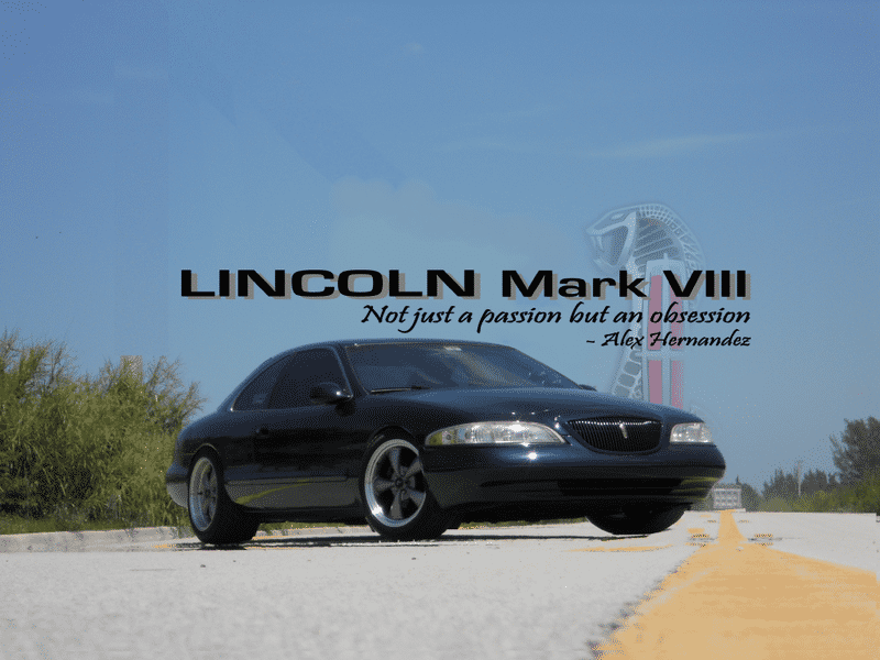

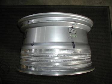

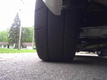

Since your opting for a wider rim than stock, here's a couple shots of mine. The rim started as 9in wide with a +36mm offset. However a company widen them so I'm not positive about the new offset, I would guess somewhere around a +50mm offset (just a guess). I'm running a 285/40/18 with no rolling of the fenders and almost a full inch clearance of the bigger addco swaybar.
Very Nice! These cars look SO good with fat tires stuck up underneath them. If you could could you post in this thread, it would contribute allot! Thanks!
