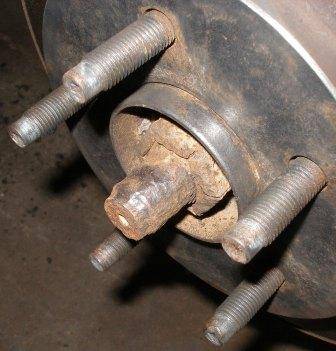

How long do the rear bearings last I have 136k on the car. What's the best way to get those off if the threaded end of the half shafts is completly rusted over

If the end of the shaft is really rusted I would zap it off with an impact... if you don't have one just go down to a local shop and have them zap the nuts off for you.
Like this?
