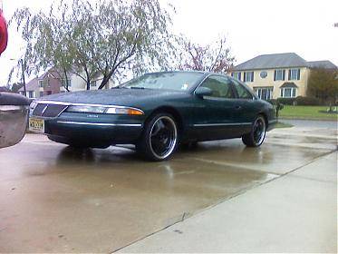

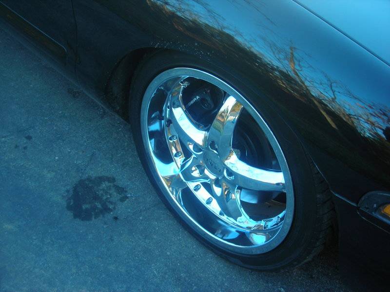

Those are all the other pics i have of that car with those wheels, heres another favorite of mine.

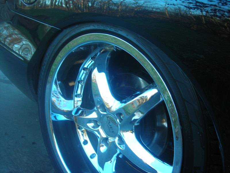

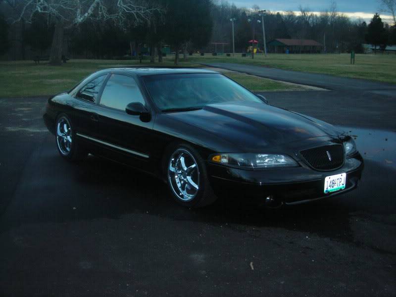

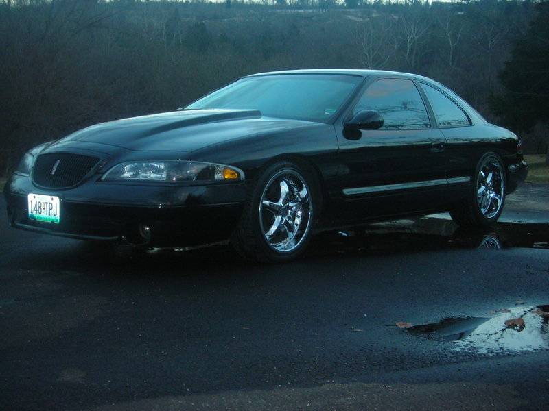

I have 20inch black bullet wheels on my gen2 the rears are 10 inch wide and the offset is 44mm if i can remember, the rear wheels have a nice 3.5 inch lip .I went with a 275 tire because I heard that was the widest you can go on a mark,but with this offset and wheel width there is plenty of room probably could have gotten away with a 295 or maybe squeezed a 305.

spacers?? no spacers installed,the wheels are inside the fenders about 1/8 inch in the rear and 1/2 inch in the front when lowered,would like to bring the front wheels out about 1/4 inch but not going to happen,the rears are 20x10 40mm offset's and the fronts are 19x9.5 44 mm offset.
lee
lee

No offense taken,you were probably thinking about the other wheels i had the ziniks they set too far into the fenders wells and needed to come out 1 inch in the front and 1/2 in the rear,the spacers created a vibration i didnt like.
i was way wrong on the front wheels they are 19x8.5 35mm offset,they had to special order the fronts but had the rears in stock.the bolt pattern is 5x4.5 here are some more pics.
