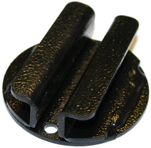

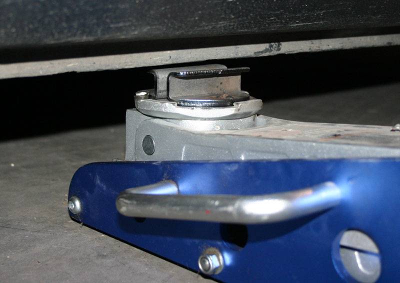

Basically, put the lift points under the notches where the scissor jack would go.
i dont like those... but you can, plenty do...
not a big fan either...
if your just using a jack, its going to crush the metal sideways.
if you do want to lift from there, I would highly recommend getting/making a jack adapter.

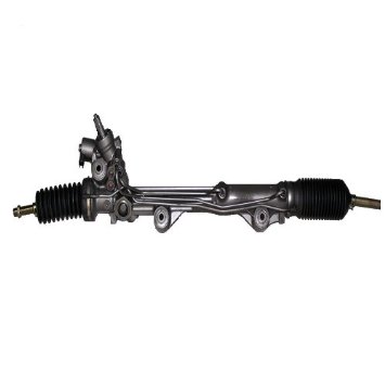

illyc, the front outer alternate points are those round mounting bosses in the steering rack, as far as I know. I don't know what the middle one is, though

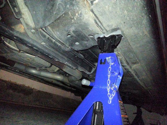

Personally, I jack it up from the notches and place the jack stands under those thick metal bars about 9" in from the notched rail. They are long, flat, and stick out relatively clearly from the sheetmetal. I believe they're on the bottom of the square tube rail that turns upward with the exhaust. You can see it here in Rig's picture
Just to add: Part of the reason I prefer using those bars is because I initially thought (what I now know is the steering rack) it was aluminum based on it's color, and we should all know here you don't jack up aluminum. I assume it's steel, but I still don't like using it because the points are very close to the center of the car. Besides being less stable on stands, I was jacking the car pretty high off the ground to get enough clearance. On the flip side, being cylindrical in the right direction, they do respond well to the rotating the car does as you jack up the other side. I just stick to the bars and jack it up slowly, maybe 2 or 3 notches at a time after getting the stands in at the lowest setting.
