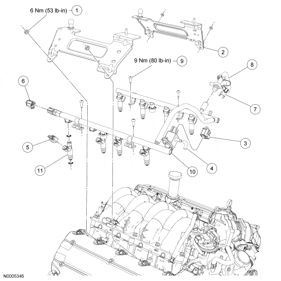

here is a pic,
When you say engine cover do you mean the plastic one right on top or the one on each side that covers the spark plugs/coils??
Thanks for the reply.
The top, center one. Just pull up on it and the two big plastic screws with pop out. (You can unscrew them if you want to take longer, but either way no harm is done.)
