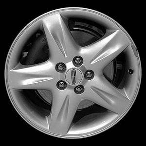

I have a set of Lincoln LS 17" wheels I am wanting to put on a 2003 Mercury Sable. Can anyone help me with which Lug Nuts I need for these wheels?

Did all LS wheels take the same lugs?
All LSes have the same lugs. Yes, those are OEM-style lugs. However, be warned they have a tendency to separate. There is an 18mm nut with a 0.5mm shell (for a 19mm total size) that likes to separate and spin around the nut. Other than that, my 97 Taurus and LS have the same lug size, M12 x 1.5 (diameter x threads)

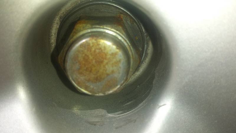

you are thinking they bottom out before tightening against the wheel?
because i have not noticed any issues.
the lug nuts have been on the car for quite some time, and i have rotated the tires a few times as well.
2015-04-20 15.57.22 by chris2523, on Flickr
also, surface rust confirmed.
but i will take that over the stripped out 2 piece lug nuts any day of the week.
