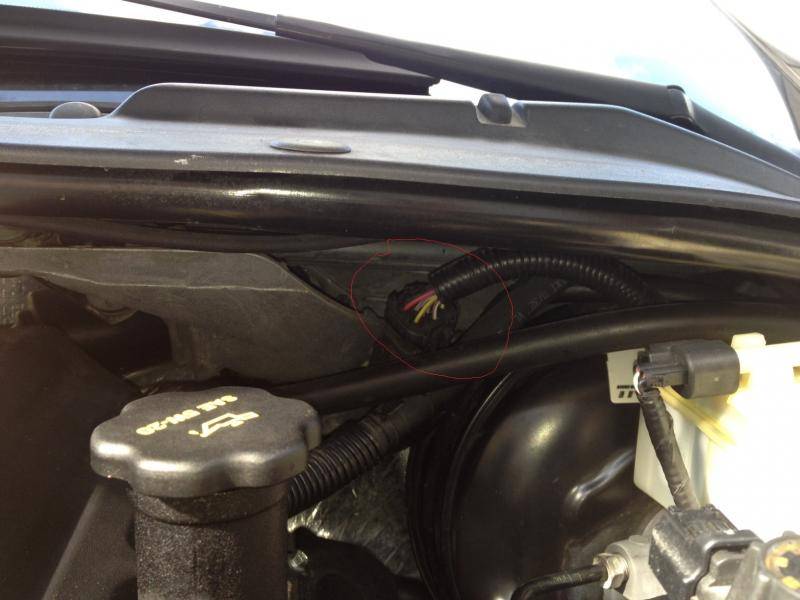

Can you give me a heads up as to where this smart motor is located? I'd like to do as much DIY as possible
I'd turn the wipers on and then tug on the wiring harness at the wiper motor and see if that makes them stop and start.
I've seen problems at the motor connector before.
