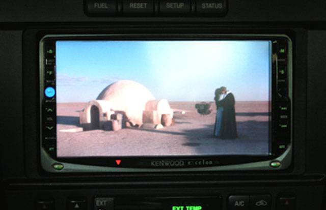

Nice setup! - can you take a picture of the radio closed up and turned on like it is now? im curious how it looks in the dash, its much bigger than the stock is sunk in the middle..
i was looking at an alpine but yours has caught my eye !
Thanks!
This pic is a is a little dark. Let me know if you need a better pic or a different angle.
Yeah that looks good, im just curious if you can 'possibly' take one in the day from the backseat of the car... The head unit you got looks GREAT!
I just want to see how large it looks in the dash compared to the rest of the dash.. so if you can sit in the middle of your backseats and snap a pic from between the headrests
Thank you SO much for doing the pics!
Oh thats all I wanted to see there man, thank you so much!! Guess i know what im getting.. not sure if its that exact model but it wont be a flip out screen thats for sure.
