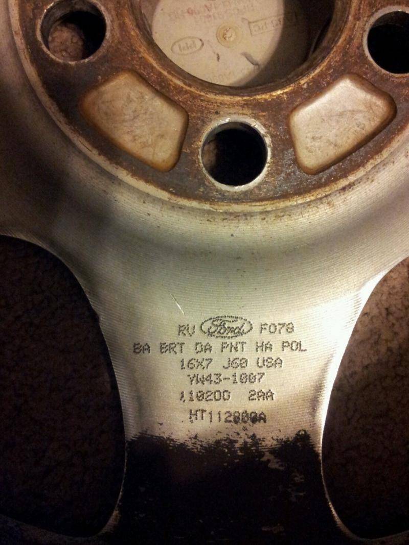

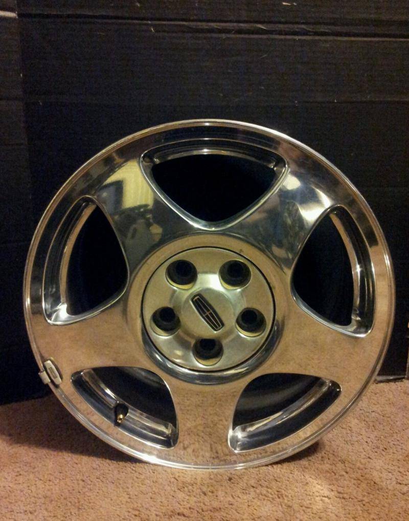

17x7.5 but 16s are 7.0 wide, AFAIK. Someone said the rim is stamped as such. Both are 60mm offset though. I don't have 16s to read myself, though
I'm guessing it's a generational thing. That person had Gen 1 16s and I found this listing on ebay for a 00-02 16x7 (according to the stamp) 5-spoke chrome rim http://www.ebay.com/itm/2000-2002-LINCOLN-LS-RIM-FACTORY-OEM-POLISHED-16-USED-ALLOY-/151810363987?hash=item23589a5253&vxp=mtr

Ahhh..... My mistake. I forgot the 16" wheels were 7" wide.....
in all fairness, the OP was asking about 17s...
Fair, but I just learned this and I just want to tell everyone. :)
Really though, it's just I've only ever seen 7.5 written as the width for all LS wheels and then someone said his 16s were stamped as 7"
maybe its rounded off due to a conversion coming from the metric system? :shifty:
