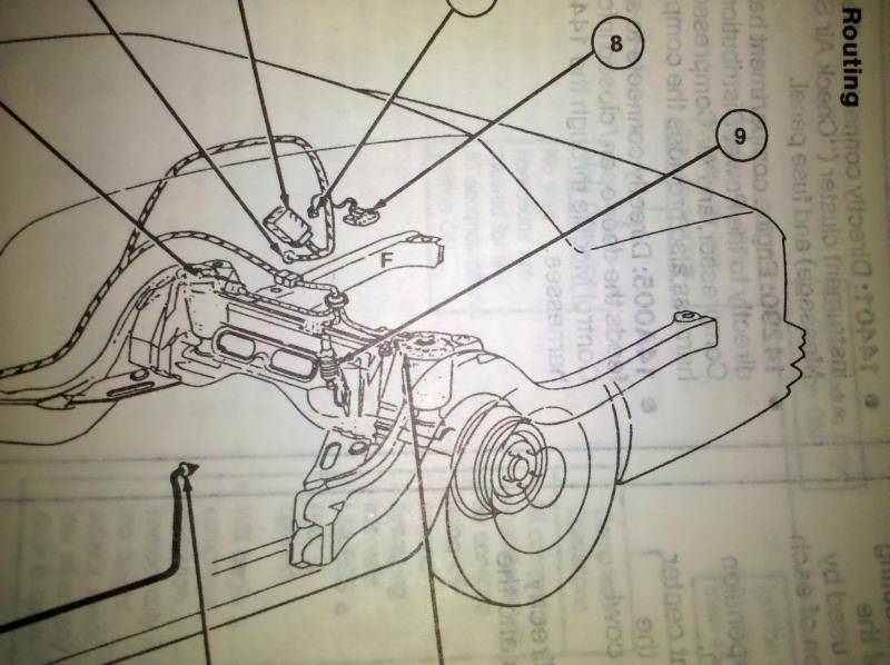

Check the ride height sensor
Is that the bar/rod in the back by the airbags? One mechanic said it might be stuck...?
I have never had a problem before. I have had people "rock" the car at different areas and nothing happens to the suspension with key on or off. If I turn key on, the compressor turns on, no movement or hissing with airbags. ?
I just sold my pristine 95 TC and I had to change the airbags in that one once, but it simply lost pressure to bags when allowed to sit for a week. This car--my 98-- actually lowered itself when the key/compressor came on!
This might sound dumb, but check the Air Suspension switch in the trunk (Driver's side). Turn it off and back on. See if it helps. Otherwise, yeah it seems like it could be the ride sensor has failed.
^^^^ hope this helps #9 is the sensor
