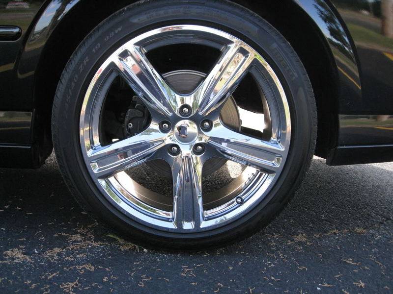

Hey guys was just wondering if the above jaguar rims would fit my 2000 lincoln ls i have heard most rears offset are toomuch and you need all 4 fronts but these are a different verison then the senta wheels they are the 19 xj8s i know that the bolt pattern os right but when it comes to offsets and all that i get headaches lol if any one knows any thing let me know and also does anyone have pics with these wheels or other jag wheels id really like to see

Everything I have read on here about the Jag wheels, the rear pair of a staggered set do not fit. Someone who knows better will probably chime in. Good looking set of wheels though.
Unfortunately I don't have an exact answer but I do have Jag XJ rims on my car and they fit fine. I went through a similar situation to you as I needed to ensure all 4 wheels were front.

Don't hold me to this, but I would think that if they are all "fronts," they should probably fit - If I were you I would contact the seller and see if he can find any more information stamped on the wheel.
If the rears are different than the fronts, I don't think it'll work.
All 4 of my wheels are 19x8.5 with a 49mm offset.
From what I understand, they also make the same wheel 19x9.5 with a 31mm offset that won't work on the LS.
Again, this info is with my wheels - I think it's probably a similar situation to the wheels you are looking at, but I'm not sure.
