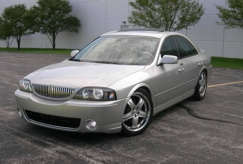

Im new with the lincoln ls, im a teenager - just got my license and im looking to getting a 2002 lincoln ls from a family member.
I've been searching around for info on the LSE body kit.
Im pretty much in love with this type as seen in this picture. no other bodykit comes close for me.
But what im unsure if this type LSE bodykit will fit on a 2002 LS model.??
Will it or is it meant for 03-06 Models.
Also, where can i purchase this type of LSE kit(in the picture)? Location, store or website.
definitely will fit, probably some modifications need to be done to get the gen2 on the gen1. sure someone that has done it will chime in..
It can be done. I believe the only thing is that there will be a small, often unnoticable gap between the headlights and bumper. LSKoncepts.com will have just about anything and everything you can think of for this car.
the trunk lids are different between Gen1 and Gen2 - it is possible to have someone heat and re-shape the bumper cover to fit - but it's not a direct match.
the LSE version for the 2002 is very close to that kit - not sure they make them anymore - Ken at LSKoncepts will know for sure.

Yeah, definitely will NOT fit, not completely. There is a small but noticeable gap between the headlights and bumper cover in front, and the rear is a completely different design, the '02 LSE kit is a one-piece valence while the '03-'06 is a three-piece valence.

Wow, that looks radical.
Thats what i hope to achieve. Im in no position to talk but i think it'd look tight if you got rid of the orange there on the front lights. Just my 2cents

DO you mean this to be gen1 and gen2 being the kit in the Pictured LSE above
Also, aside from the front bumper, will all the other 03-06 side LSE skirts fit on my 02 LS model
That is the Gen 1 LSE side skirts and rear, with the Gen 2 front end.

That is a first gen LSE. First gen bumper, first gen skirts, first gen rear valence.
All side skirts are interchangeable between all year LS'. The rear valence on the first gen will only fit the first gen rear bumper.
