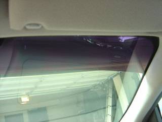

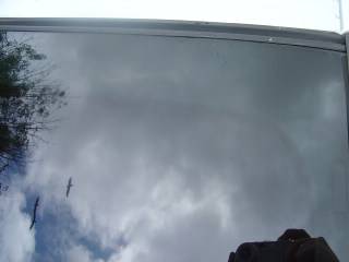

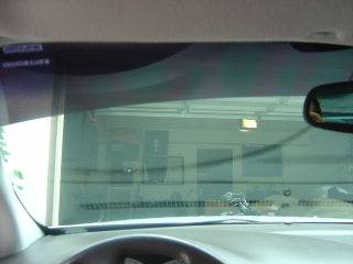

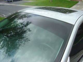

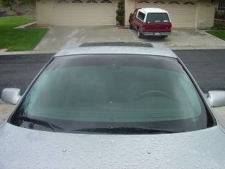

Mine has the Dot Matrix as well but here are some pics of my tint.
Sorry for the pics it's ben raining today, I did the best I could. The one with the reflection of the camera, you can see the faint line of the dot matrix line, no bubbles or anything. If need be I can roll the LS into the garage and get a better nonreflecting pic.
