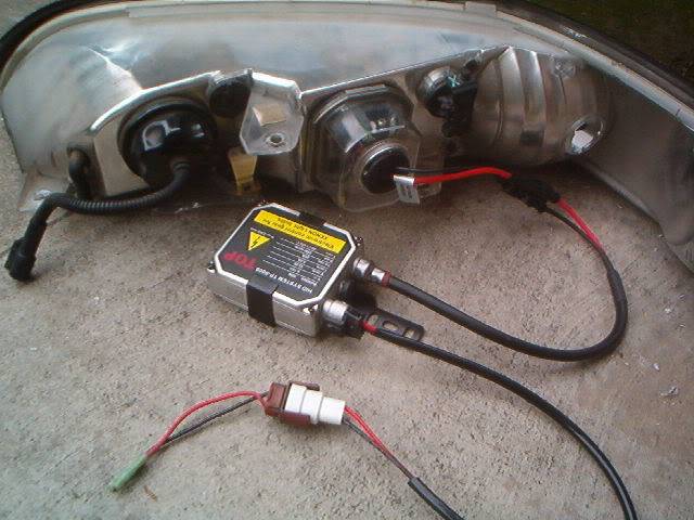

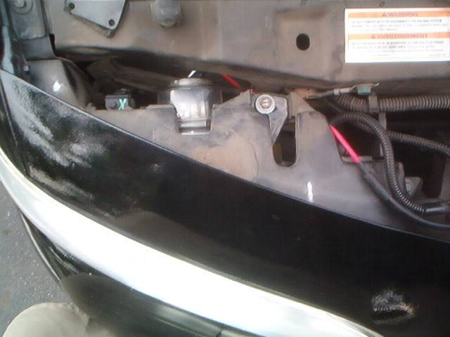

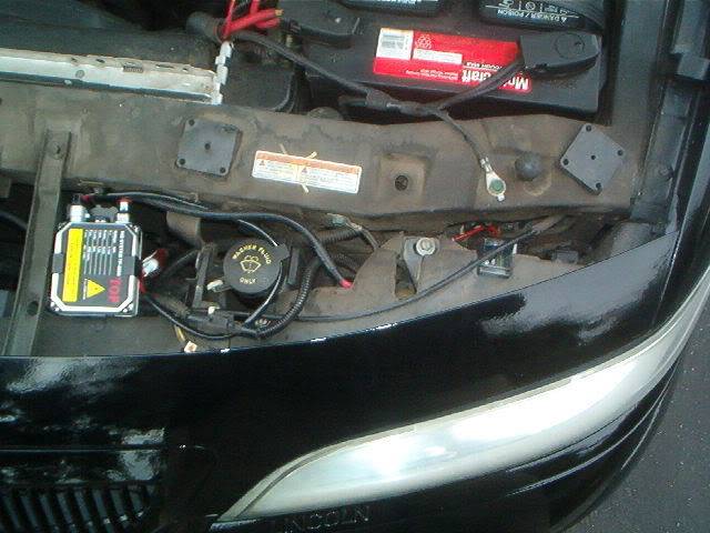

working on it!!! Well, I am not using a 9006 hallogen bulb, I am using a 9006 pigtail onto the lincoln's HID harness, bypassing the ballast and from that 9006 pigtail I am installing a HID conversion kit using the kits own supplied Ballast and the kit's HID bulb. I am designing a plate to screw into the 97-98 lincoln's headlight that is precut for a 9006 style bulb. The new HID bulb will then be inserted into the factory lense housing and will secure by twisting the new bulb into place just like any regular hallogen bulb.

I started the conversion, I got one side in and it is a complete success! I am currently working on the other side. I do also have a working OEM HID bulb that I am taking out that I will throw on ebay. If anyone is interested in a spare let me know. The pics of the kit will be up shortly, and the comparison of the light output. The converted side appears to have a brighter whiter HID color, As soon as it gets dark I will be able to tell if the light pattern improved or got worse. I will keep you all posted!

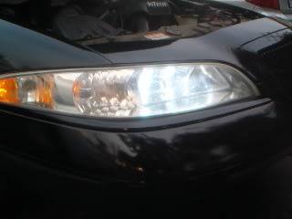

HID conversion is complete! Here are the pics-

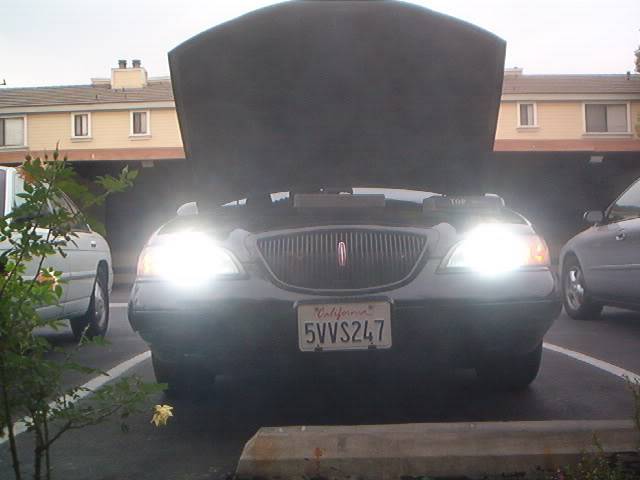

ALOT brighter then stock!!!
New HID^

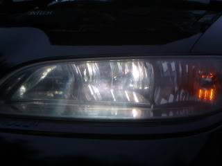

Old HID (stock)^
