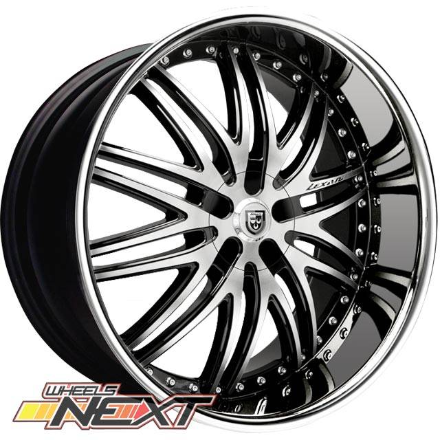

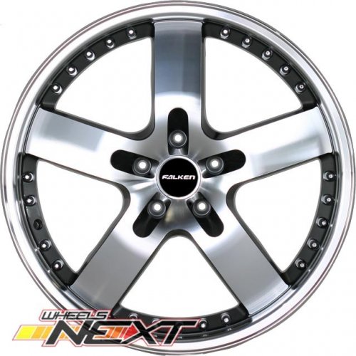

btw, the 1st ones are 1500 wit tires, and the 2nd are 1100 wit tires...
I like the 1st ones, but no go on the 2nd. What size are these? I'm just looking at 17's as I just got brand new tires.
And by the way your opinion SUCKS!:D
i only put the 2nd cuz u sed u like 5 spoke rims with no lip....but i hate them too...

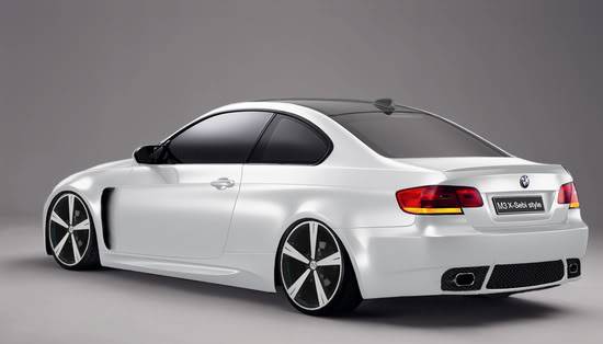

I do like the ones on the white BMW I posted a pic of. What size is the first rim you posted? I looked on wheels next under 17's but didn't see it.
