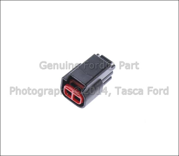

Hi guys, I've been searching everywhere online for this but the prices are exorbitant! (like $40+ with shipping).
Car: 2006 Lincoln LS
I need one since the clip broke yesterday on one of the plugs when putting in my new coils and plugs. It's the clip part that plugs into the coil.
1f1z-14489-aa
Anyone able to throw a few ends in an envelope and send to me? I'll pay you for it.
Really??? Are you any good with a soldering iron?
STANDARD MOTOR PRODUCTS S819 {Click Info Button for Alternate/OEM Part Numbers} Info
Black; 2 Term. Female
Also known as Borg Warner PT5749
Either available at you local auto parts store. Comes with 2 pigtail wires. Get some heat shrink tubing to go over the solder joints. Takes about 10 minutes. Even butt connectors would work in a pinch.
