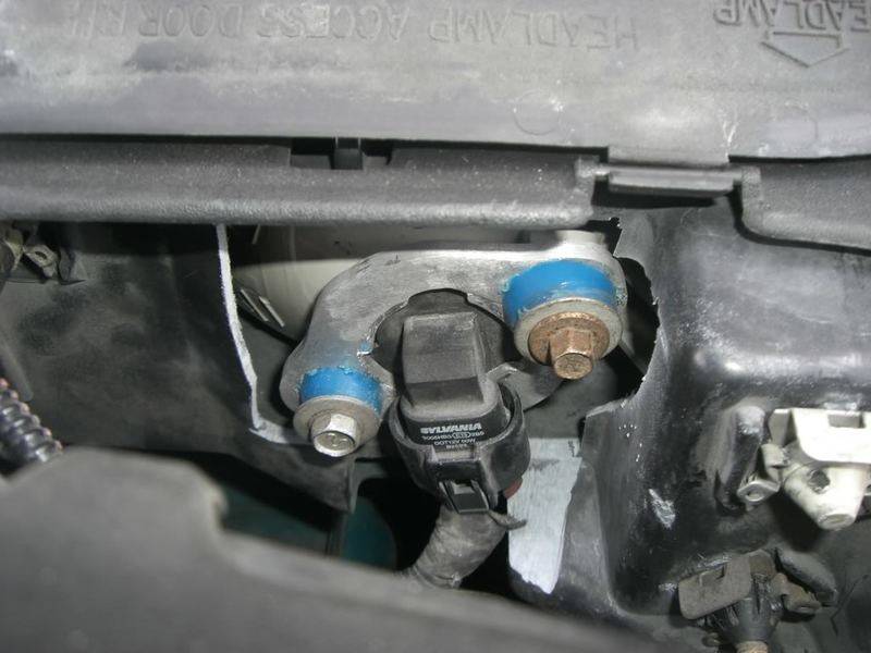

make your own bulb plate. i was in the same boat, i bought a pair of housings, and that black football shaped plate was missing on one, so i took a piece of 1/4 inch aluminum plate, took the other one off the housings, traced it on the aluminum, used a cut off wheel and an air grinder with some carbide bits and made one myself, exactly like the stock one, holds the bulb perfect.
fatory side:
and my home made one:

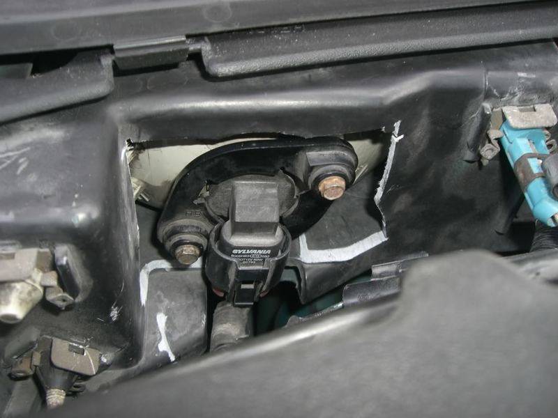

because my car is a 93, 93-early 95 header panels are different then late 95-96. the hole for the high beam is too small for the housing to fit so you have to cut the hole out bigger, i got a little carried away, but you cant see it so i dont really care lol. normally i dont do anything sloppy like that.
Thanks for that info. I want to put these in my 93. I need a header anyway, leftover damage from the spinout, so I'll look for one from a 96.
