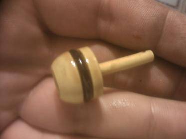

first off let me apologize by putting this thread here. i just happen to trust my fellow mark friends when it comes to good info. anyway can anyone identify what this part is and where it goes. all i can tell you is it fell out of a transmission on a 2002 mustang. thanks in advance.
Its put in the trans tube hole to keep dust and dirt from getting in the trans while in transport to the factory, when the factory recives it they push the dip stick tube in and push that plug into the pan. Its nothing to be worried about.

Im 110.999% sure thats what it is. Just try and put it back into the hole and then press the dip stick tube in, the plug will fall out.
It's good and bad. Good- it won't be goin back in, unless you think there should be something rattling around in the pan. BAD- You're pan has never been dropped before.
well i hope ya guys are cuz he already put the it back together and is filling it full of fluid. we couldnt get a good luck to even see the dipstick hole the car wasnt jacked up high enough really see. so we can only hope. anyway jr if you want to pm me the address ill mail that out to ya on friday.

Nothing more than a disposable bung. Mark VIII's had them, too. (the question has come up before)
Straight out of our tech section: (http://www.lincolnvscadillac.com/tech/lincoln-mark-viii/Transmission-Filter-Change/index.htm)
If you find a little plastic plug with a rubber o-ring, don't worry, this was in the dipstick tube while the engine was assembled on the assembly line and falls into the transmission pan. It's not a broken or missing part! Discard it or keep it as a souvenier.

Yeah its there for assembly purposes..your not the first to ask, ive seen it come up on numerous boards. ;)
