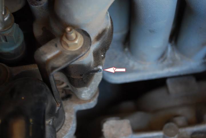

Can I just grind this "tip" down a little? It's on the front intake tube:

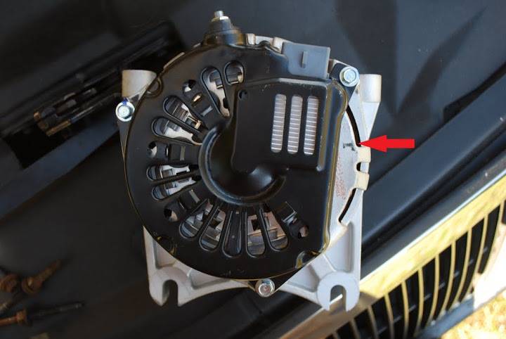

I bought a reman'd alternator from an auto electric shop in Columbus GA, about 1.5 hrs from home, and it touches that "tip" right here:
That keeps the bottom bolts from snugging up correctly, and also the top left bolt hole (looking from front of car) from lining up with the hole in the mounting bracket... by only about 1/4 inch or so.
This is "supposed" to be a Gen II alt. and I've seen plenty of people say they've put G2 alts on Gen I's w/ no problem.
I sure don't want to have to drive all the way back over there to swap this thing!
that's weird. i've never heard of such an issue...
but yeah, i suppose you could.
well, that figures
If anything weird can happen, it's gonna happen to me :rolleyes:
I went ahead and knocked a little off the corner with a side-grinder, dressed it with a dremel, and she mounted right up snug and square. Putting out 13.62v at idle right now and everything seems to be fine.
Thanks guys...
You may want to double check that snug n square theory. Putting a gen2 alt on a gen 1 sometimes requires slotting the bracket holes so the top of the alt isn't tilted back towards the car...

I had to grind my intake the same on my green 94.
This used to be a common issue, not sure why it's not so much now.
Maybe it was just an early gen 1 issue.
