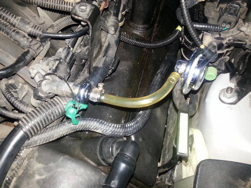

I told my girlfriend last winter that this car HATES the cold. The negative temps are what lead to my Advancetrak lite to come on and its been flashing ever since. Now, its because the fuel line right after that FI damper is frozen solid.
Perhaps you have too much water in your gas tank?
oh yeah. Aside from our gas station here in town that has questionable gas at times. The tube was solid. I used some clear tubing to see whats going on and the fuel does proceed into the line but stops shortly after. When I took the clear tube back off and the fuel jetted out from pressure. So this leads me to believe the section after this clear line is frozen also. fuel tube.jpg
