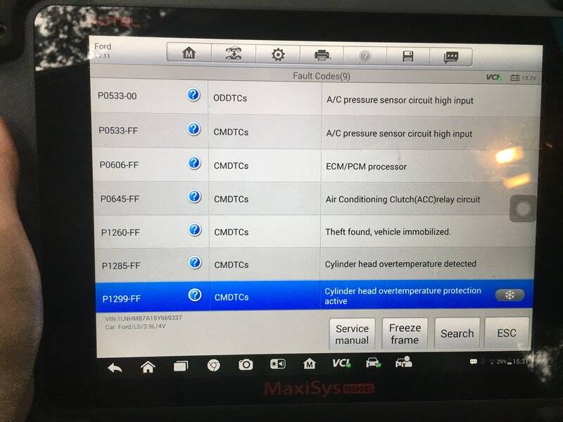

now before I go further. The DCCV was the first thing changed, vacuumed the System down, recharged, bled the coolant. Ran fine but still no AC. So we noticed the compressor wasn’t kicking on so we changed it. Then that didn’t fix it, so that’s when we did all the internal parts in the dash, followed by later the condenser. Before the condenser that is when we noticed the #1 fuse was blown and the wire harness to the DCCV had two completely severed wires in the harness. We replaced and repaired and no change. Got another DCCV, no change. We think the first one was used since it was a $30 eBay part so we decided to splurge and get a new one for $120. Now right now we facing issues still. the system won’t take all the Freon needed, it’s only taking half, the compressor clutch won’t engage to take the rest, my autel shows me ac pressure sensor high input. And when we put in the number 1 fuse, the car won’t start, if we take it out, the car will start and then we can plug the fuse back in. But if you cut the car off and try to restart it it’s a little hesitant but it works. Also, with the car on or off, with the fuse plugged in the aux water pump starts whirring and won’t cut off, one day we accidentally left it in over night and the car was dead the next day. All the relays have been changed. I was debating on replacing the aux pump but it’s $300 at advance and it seems to be working. And another note, when you plug in the fuse while the car is off the throttle body will open and close a little Until you get the fuse all the way in. Now we are on a pause with the ac system since it still won’t work. Because after having done the condenser and having to take the radiator off, the thing just won’t stop over heating. We have bled and bled and bled and topped the system but it still overheats. The autel shows me code P1299 cylinder head over temperature protection active. So I guess our next plan if action is to replace the cylinder head temperature sensor and the ac pressure sensor, vacuum down the system and recharge and try again. Any advice on what should be checked? I’m honestly about tired of working on the AC and getting ready to sell it and get something else. I’ve went through spring and summer with no AC in 90° heat and it’s almost fall now. What should I do next?

I note that you have an internal PCM fault code. You should probably send the PCM in for diagnosis/repair as well, but you need to fix the wiring faults before you re-install it and damage it all over again.

I see that you have a professional scan tool, but I still recommend that you get Forscan. It will still give you a lot more detail than that tool.
