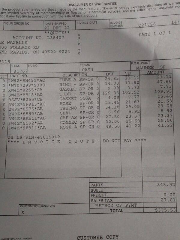

That small hose coming off the back of the gooseneck is "special order" from Tennesee... and will cost an extra $25 expedited shipping fee if you want it in a timely manner.
Same for the TB heater hose that goes to the top of the T-stat housing. Best to order both at the same time so you only pay the extra $25 once.
Here's a parts list for almost everything you would need... to do a complete OEM rebuild of the cooling system... minus the degas bottle and water pump... aux pump... DCCV... and the larger hoses to the radiator. One package of o-rings comes in a 4 pack only... so you will have 2 extra. No way around that.
My prices will probably be lower than what you will pay... due to customer loyalty discounts.
Total for everything (for me) was right at $400... tax included... plus the expedite fee.
