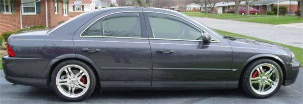

I am considering buying a LS V8 Sport, and have been looking at cars on this site. I like 'OhioLS' car with the 18's on it...does anyone know if this car is lowered or stock suspension? I found the tire size.

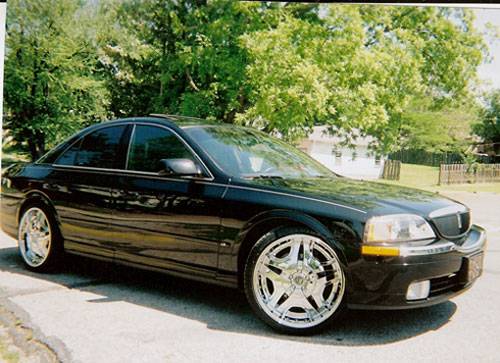

Also, I may look at 20's for it....what is the recommended tire size? I found some nice ones on this site http://www.20inches.org/cars/cars-linc.htm but it gives no info on tires or suspension. I am hoping I do not have to lower it and have it still look good. I am hoping to get this look, so info on tire size, offsets and suspension set up would really help.

i have Wanli 245/35/20's on NS Racing Vegas 20" rims, here's a shot:
the suspension is still stock and the only issue i have is rubbing on the passenger side rear tire on tight turns and bumps, amplified with more than two people in the car of course... otherwise drives great.
the car picture u have looks like an LS on 20 inch dub rims.. or TIS.. same company.. anyways.. doesnt look dropped.. when its dropped it tucks the back more than the front usually and u can tell..

isnt that ohioLS car? i beleive he did drop it on eibach springs.. not 100 percent sure though. i know he bought the wheels at lskoncepts.com though
OhioLS (Scott) does have an Eibach 1 inch drop. I think his 18's look perfect compared to the size of the car, although in some occasions 20's look good too. I'd go with the 18's though.

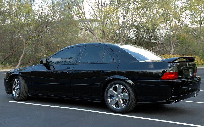

Looks like 18" 45s maybe. By way of reference, mine has 235/50 R17 and a 1" drop (Eibach Pro-kit springs). A 235/45 R18 will have an overall diameter almost exactly the same, but with a lower-profile tire offsetting the larger-diameter wheel.
looks sick sloban! i actually like that spoiler, never thought i'd say that. as for tires i think both 18s and 20s look great on the LS. anything less, you lose that aggressive edge, and looks more like a honda at that point (ok... flame away... hehe)
