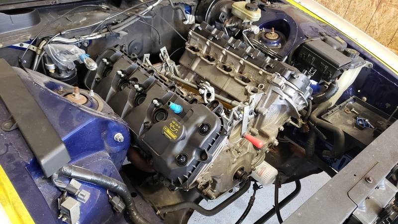

2017-08-21 20.11.43 by Chris, on Flickr

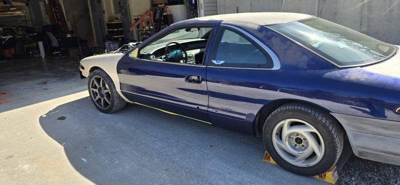

looks clean in here. engine has a touch under 100k.

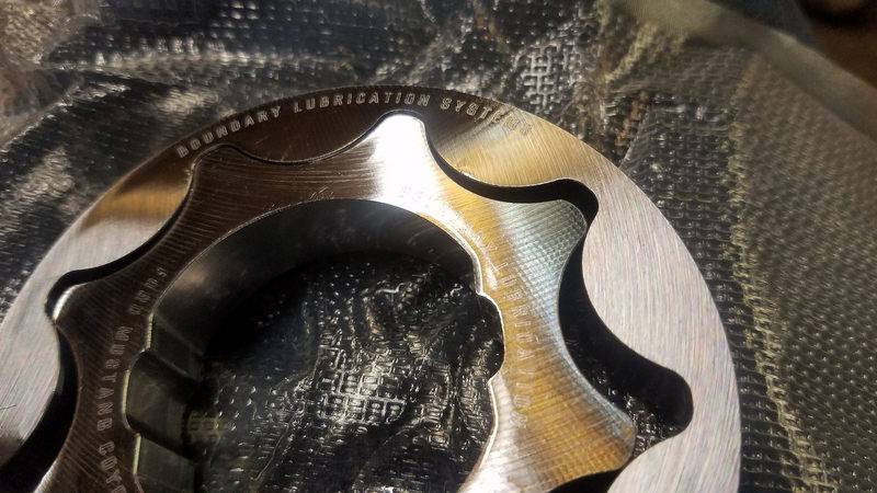

2017-08-21 20.56.38 by Chris, on Flickr

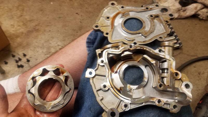

got some Boundary billet gears to put in the oil pump.
2017-08-21 20.53.31 by Chris, on Flickr

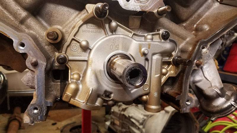

the housing and stock gears.

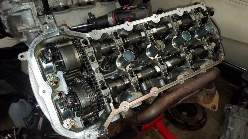

2017-08-21 20.44.41 by Chris, on Flickr
going to learn how to time it tomorrow.
I decided to replace the chain guides because they aren't that expensive.
they are on order.

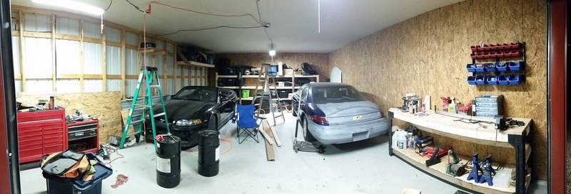

went and got me a place to work on it.
44056813_1114475902064114_7355363542893068288_n by Chris, on Flickr

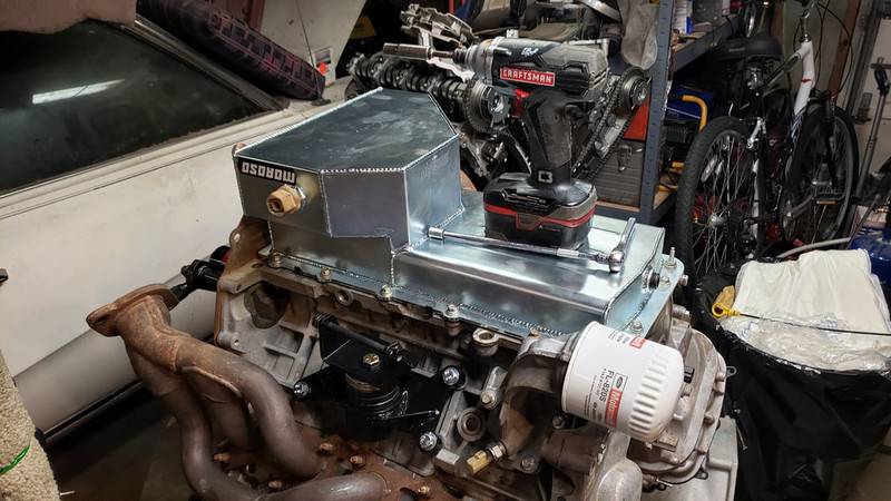

shiny new oil pan.
2018-10-19 17.33.38 by Chris, on Flickr

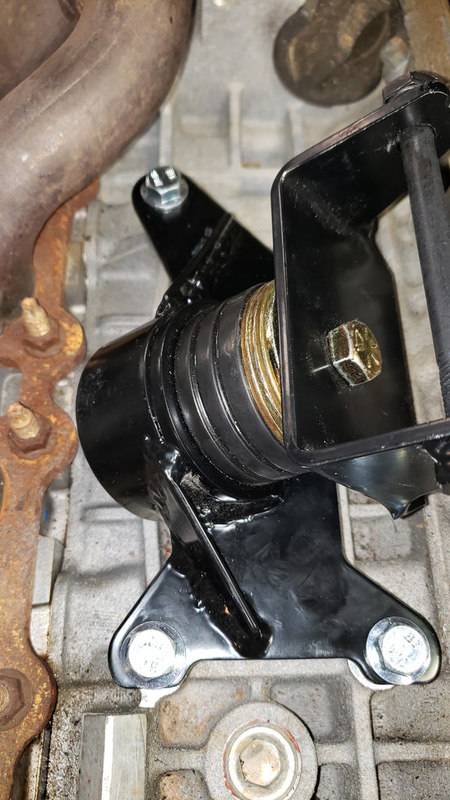

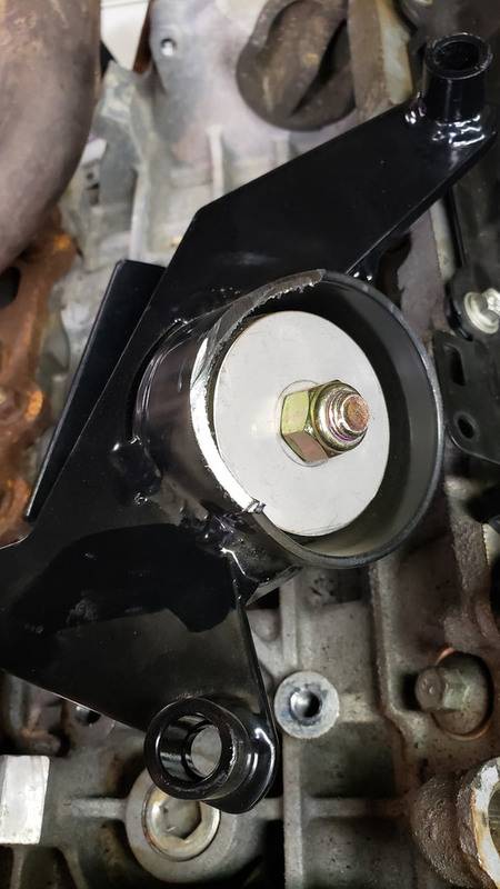

lots of trimming and the engine mounts to the subframe.
2018-10-19 21.03.13 by Chris, on Flickr

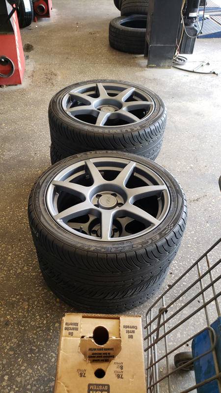

i got the wheels and tires mounted for it the other day, as well as acquired my 14" front brake kit for the car.
i'll try to get some more photos uploaded soon.

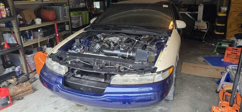

the motor is actually in the car now. not for good, i needed to test fit to be sure it would fit.
subframe will need to come back out for powdercoat and bracing.

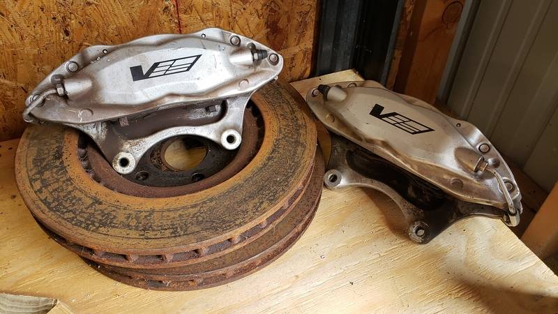

these are brakes i have for it.
V calipers and gt500 rotors. the eagle eyed among us may remember them being on lobirds car.

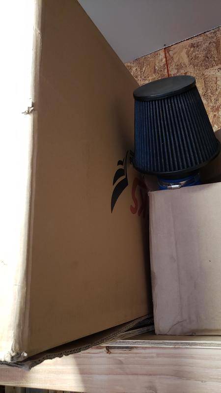

3 core radiator for the car. a sneak peak of the cai that came with the engine.

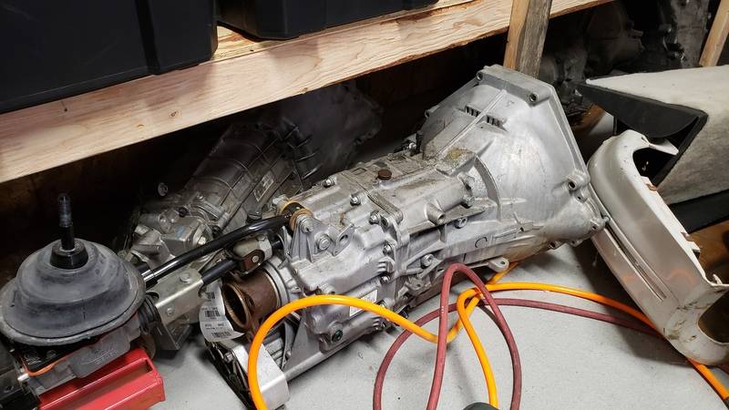

an mt82, a 3650, and a 4r70 in the back.
mt82 with a barton shifter for this car. 6060 when i break that.

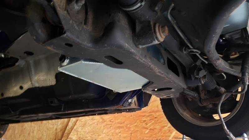

the modded spindles and the coyote fuel tank.
plan is to convert the mark tank to returnless, and wire the coyote fpdm to run a new fuel pump in the mark tank.

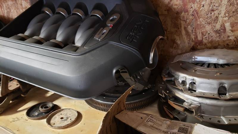

my intake and stack of clutches. i have too much stuff in here.

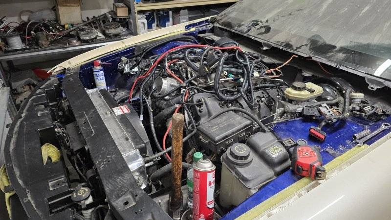

got some coolant hoses figured out and was able to get the engine up to operating temp. tstat and fan work and it has oil pressure.
all looking good.

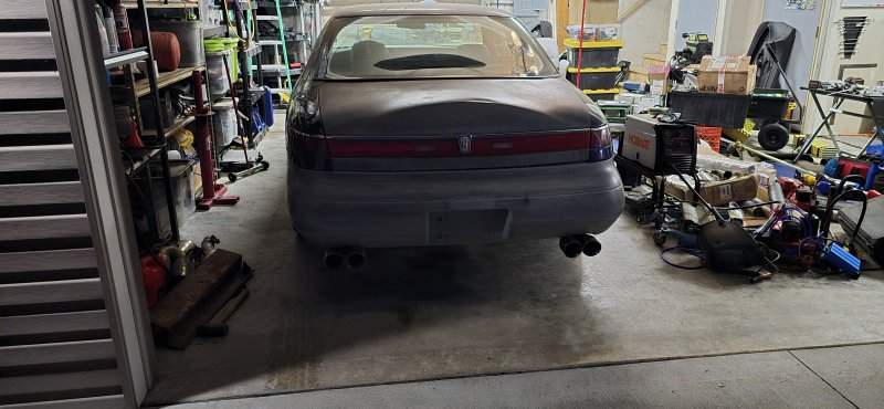

car is mobile under its own power now.
brakes still squishy, not sure what's up there.
installed a volvo electric power steering pump.
probably gonna move the battery to the trunk.
not sure the hood is gonna clear.
lots of little things left to do but its cool that I don't have to push anymore.
