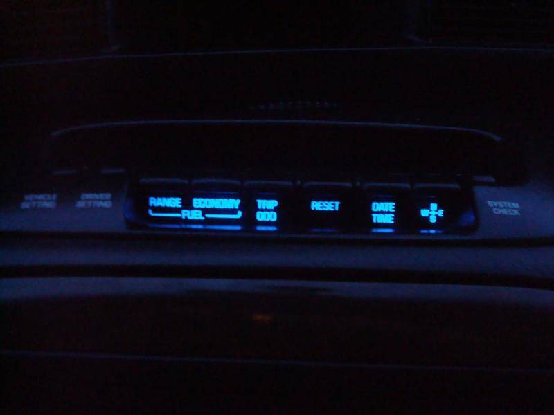

I put new cruise buttons in mine, not bad at all. If you are going to put blue led's in the cruise buttons that will be a treat. Door handle pockets would be easy.

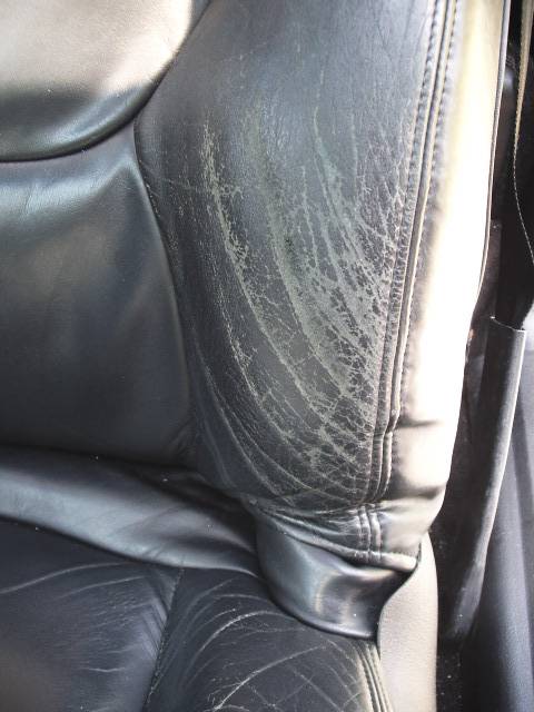

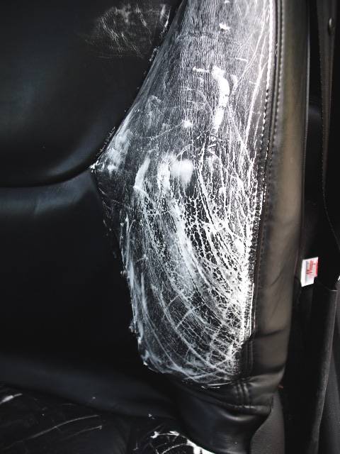

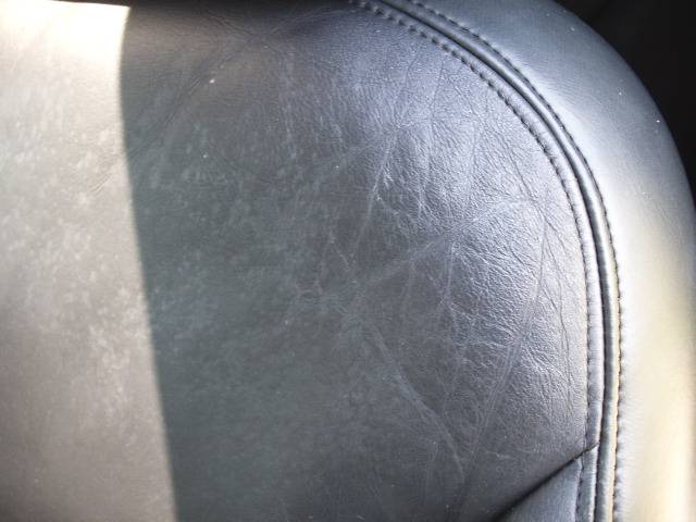

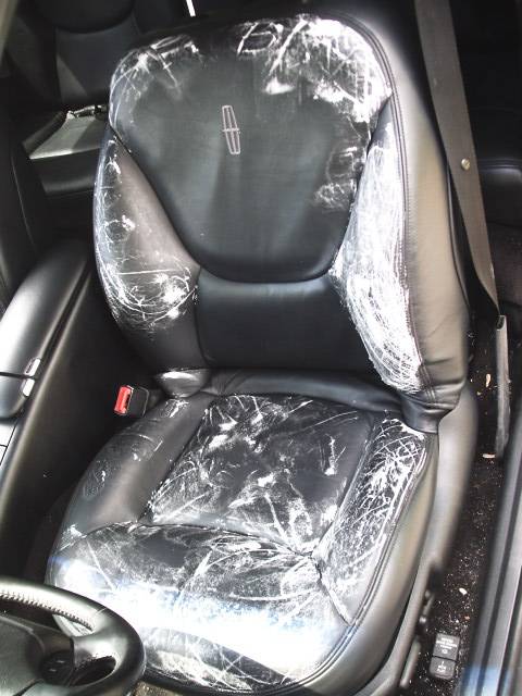

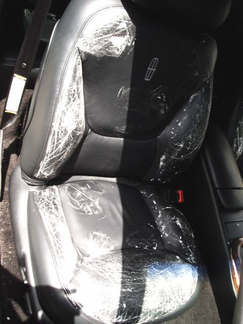

Now on to the seats. I used leatherrepairkits.com for the products. You can select your interior color code and it also comes with repair compound and everything else you need to get the job done. I was very happy with the results and the color matched perfectly.
Some problems i was dealing with:

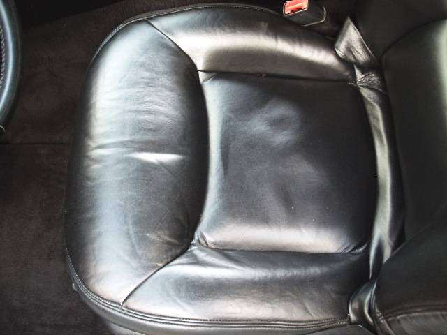

Repair compound done and ready for the color:

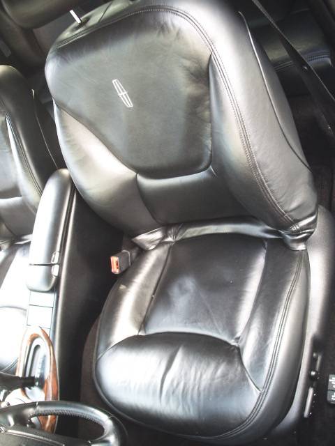

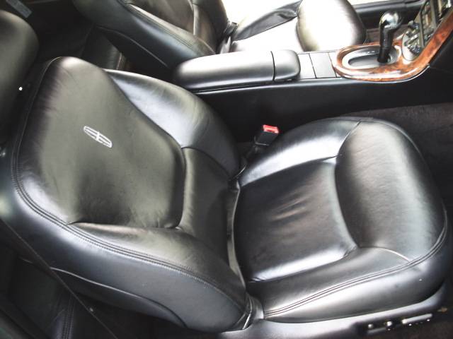

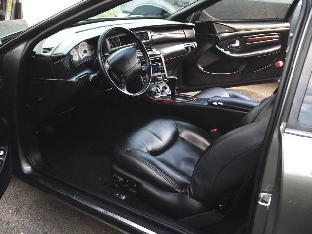

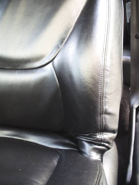

Done! The seats came out way better than I expected:
I just ordered the kit for my prairie tan. How about odor? Is it odorless? Does it smell like leather or does it smell like chemicals?
Actually I don't remember any smell at all. And I was driving in it 3 hrs after with my wife and she definatly would have said something:) One thing that I would add is they only give you a couple of alcohol pads which isn't even enough to clean the seats and you also need them to smooth down the repair compound. Get a big bottle of rubbing alcohol and an old white t shirt and youll be thankful. The repair compound is harder (longer) to smooth down then they lead you to believe so dont leave high spots or your arm will be toast by the end.

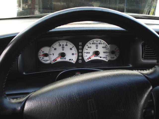

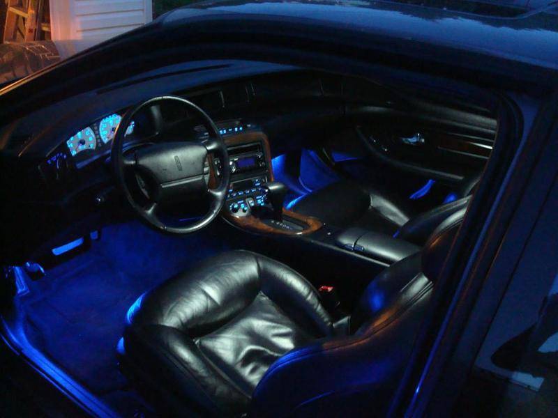

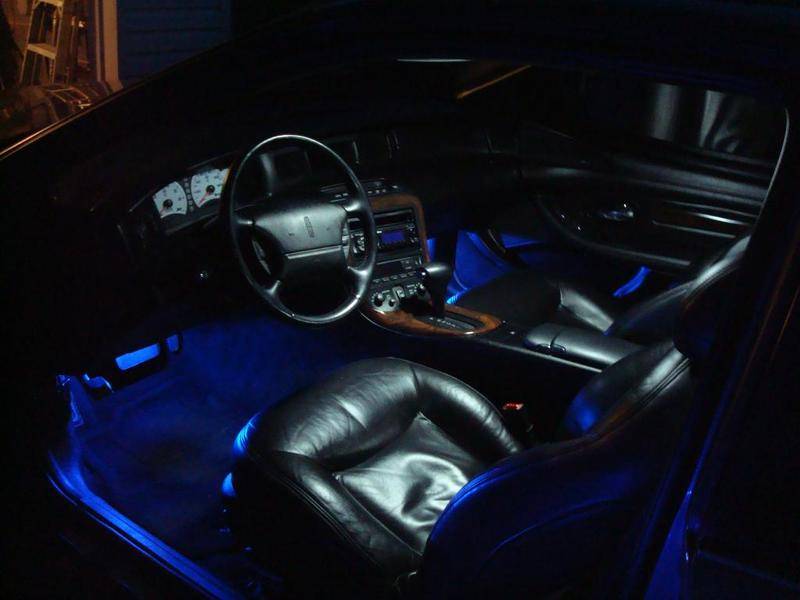

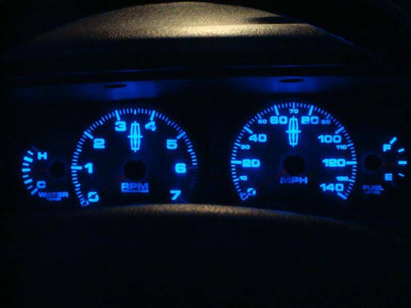

Time for the white face gauge install, interior lights, puddle lamps and night pics to see it all in action.

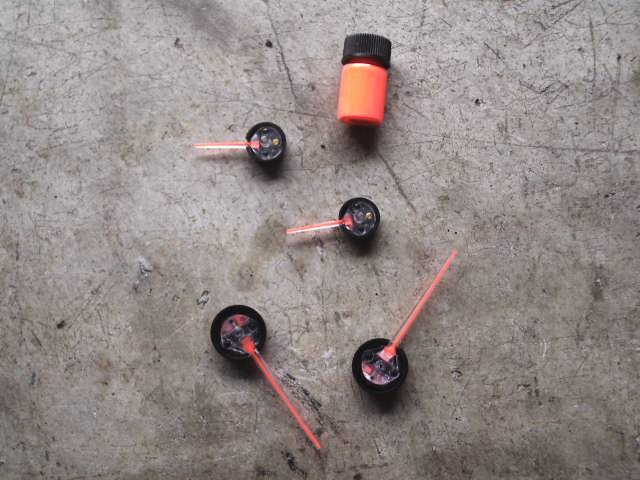

Scrape the old white paint off of the needles with a razor blade and repaint with a flourescent red paint. I used the white face gauges form Temple Performance and they are awesome. They are a true replacement not just stickers and are of equal to better qualiy then OEM. Just peel off the old decal remove the double sided tape and stick on the new one.

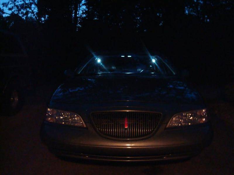

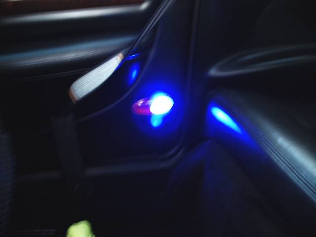

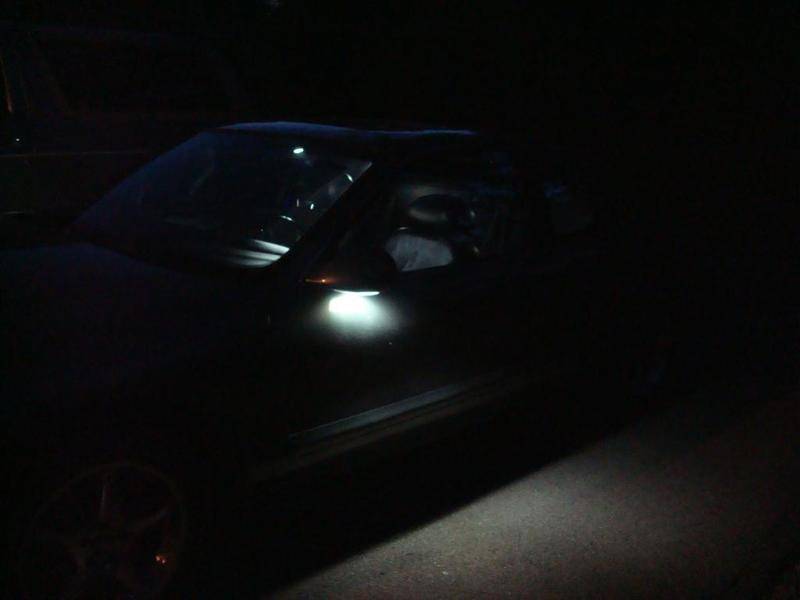

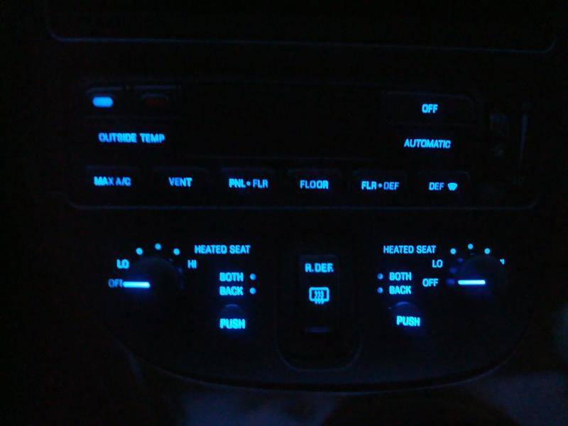

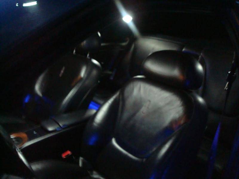

Interior lights: dome, glove box, ashtray, quarter panel and under dash are all T10. I used white in the dome, quarter and glove box and blue in ashtray and under dash. The doors are 36 mm festoon bulbs and I used blue. The puddle lamps are T10 as well.
And now time to see the night shots!!

Can you please explain how the white face guage change works? I'm unclear if those are actual guages, or stickers over the original guages, and how you accomplished it? Man, those look fantastic! If it's not to pricey, I would like to do that on my 98 LSC.
How did you manage to swap out the stock puddle lamps with L.E.D's ? I have spares but couldnt never figure out how to tear them down and rebuild them. Kinda made me nervous to even touch it hahah
