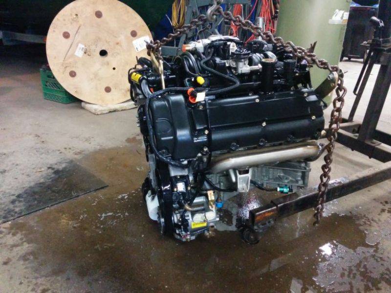

It's located in Canada though and I just double checked they are asking 2000$ CDN or Best Offer.
Which is currently $1669 USD at this weeks rate.
Shipping US from Canada is gonna hurt for sure!

Waiting to hear back on a shipping quote. The person I spoke to acted like they have never shipped anything ever before though so not real confident on this endeavor. But the price for the motor is reasonable. if shipping doesn't kill me i will be selling a few guns and picking this up. Install is gonna be about a grand as well though.

I sold some things and called in a few favors and bought the engine that Big Rig LS sent me a link to. it will be installed by a certified ASE mechanic Same one as above. If I didnt think you guys would Sh*t all over his page I would link you to his shops face book site so you can see he is quite capable. He just rebuilt the front end of a mini cooper. and did the timing chain on a cadilac CTS all with pics. Maybe he is not comfortable putting his companies rep on the line doing work on something he has never done before.
Thank you to Big Rig LS for the link to the motor. The rest of you well.....I got nothing just bless your hearts.
