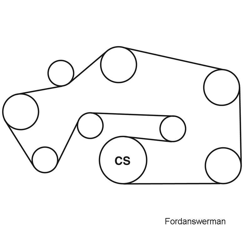

It was a bad connection on the alternator, also it didnt help my belt was going bad and loose which caused it to slip. I bought the oem degas bottle, and a new belt. In one of my previous posts I was saying the previous owner has rerouted the belt around the hydraulic fan pully, I took the old belt off and forgot to write down how it was ran. Can anyone tell me how torun this belt? Im kinda lost here.
The far left pully is missing for the hydraulic fan motor. He had it rerouted with a shorter belt. I got the part number off the belt and got a new one but have tried everything to put it on. Im so stumped
I've seen a lot of people do this on different cars to bypass the A/C compressor. You could always measure the old belt or measure the length by going pulley to pulley using string or painters tape and go to NAPA. They are usually able to match up the size and length.
well i fixed it. i got the 80 inch belt to fit without the hydraulic fan pully, and fixed the degas bottle problem. just wanted to thank everyone for all the much needed help.
