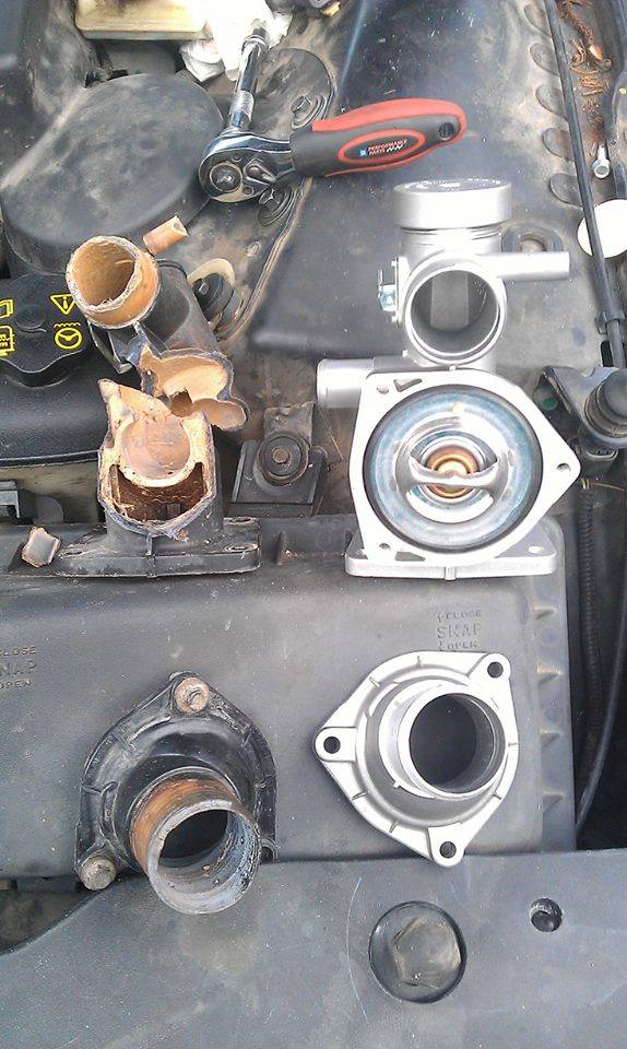

Clearly, this "mechanic" doesn't know the LS. If he did, he would have replaced several other plastic parts at the same time.

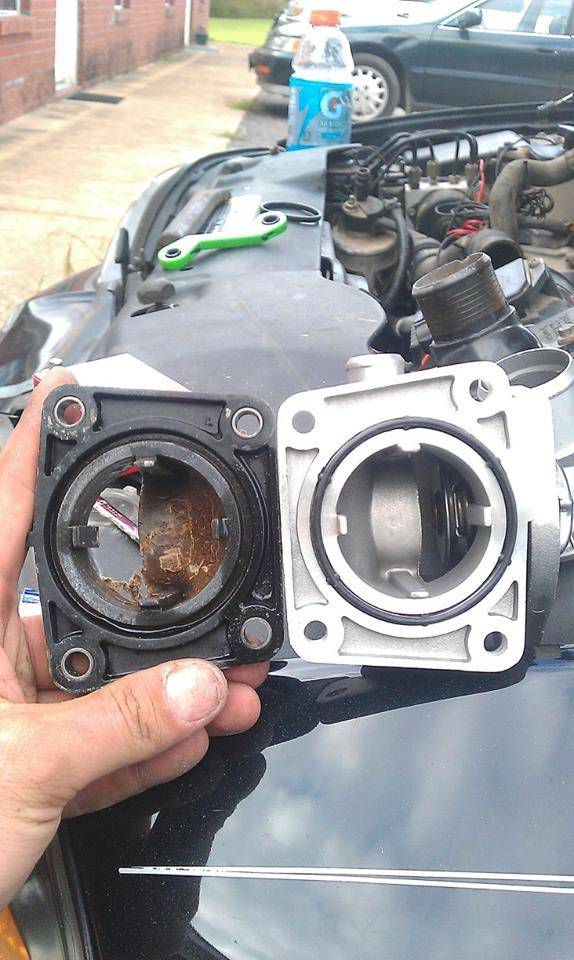

Jag stat part number in my sig,
pics

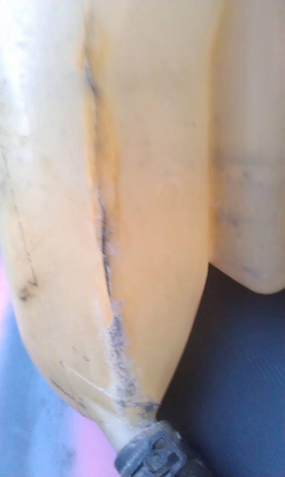

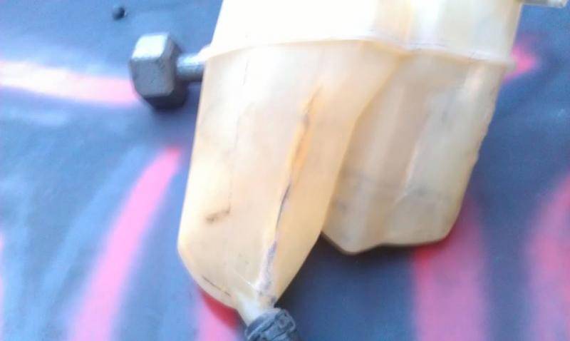

Common cracks in the Degas bottle...
Oh yeah, almost forgot... On Amazon, you can pick up the Jag-stat for about 42 and change, and as far as the degas bottle, if you can find a used one, which I don't recommend, they are about 70 bucks for Genuine OEM, and new about 150-170, worth it if you rely on your car.
Damn, I paid way more for my Jag Stat housing then that!

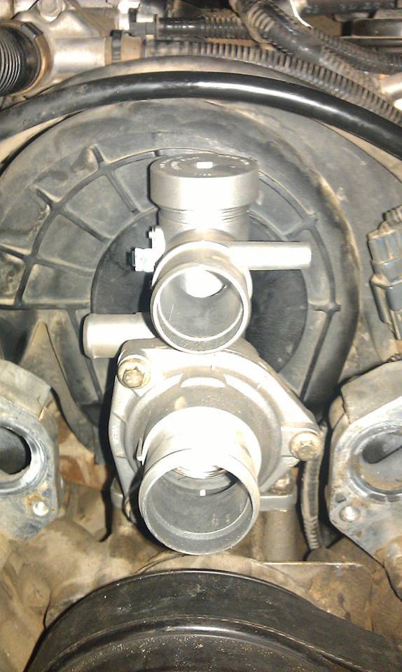

Good job, looks good, welcome to the JAG Stat brotherhood of upgraded LS owners.
+1
PS: you did put the OEM LS thermostat in there right ? the Jag thermostat is not quite right for the LS.
----EDIT: No, just finished checking my paypal payment crap and found the JAG stat housing purchase for CAD$ 49.03 I got it from Rockauto and was confusing Amazon with my DCCV purchase.
Oh yeah, Motorcraft baby! I'm trying to slowly but steadily rebuild it, make it OEM. Everyone has tried talking me out of the car, telling me it's too much headache, and not worth the effort, but it's worth it to me, and thats all that matters.
