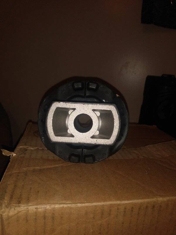

got my rear sway bar bushings a week ago and just got the two URO c2c31256 bushings today with two new c2z2226 bolts.
I hope the bushings fit, the bottom seems different from the front rears on the subframe but that doesnt bother me as long as they fit, I will keep the thread updated on how the job goes thx all
*incoming cloud of rust dust**

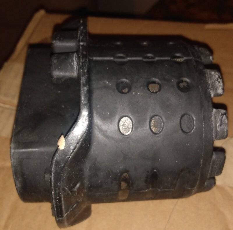

UPDATE : bushings are too big I should of just paid extra for the real ones. too bad they were only 220 for both
bushings were to big and the correct xr jag ones i can get for 450CAD kinda pricey anyoneknow if this fit the ls 2000 or any source to cheaper xr bushes or a whole sub looked everywhere but seen a few and it says its long gone..

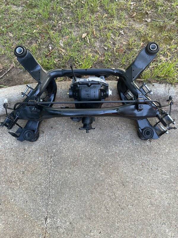

i guess just get the whole sub from a gen 2 s-type and then put your old knuckles on it. check car-part.com and call junkyards nationwide

Is this anything your needing. It’s brand new I was about to list it for sale. Has 7 miles on it garage kept til last week I had to move it to driveway.
