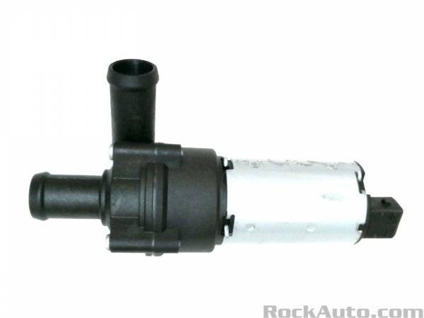

That's a very common problem, with two common causes. Air in the cooling system due to degraded plastic parts, and/or a failed aux pump. Please search the forum here for more details. There are probably a hundred threads with the same information on this problem.

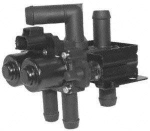

Like Joegr said it would be wise to replace the Thermostat Housing with the URO Brand it's the aluminum Jaguar S-Type and the Aux Electric pump and Dual Climate Control Valve would be a good Idea depending how old they are...As far as good brands for the auxillary pump I'm not sure if you want to stick with OEM or if there is another brand(s) out there that work well but...make sure you go with
Motorcraft YG355 Valve
