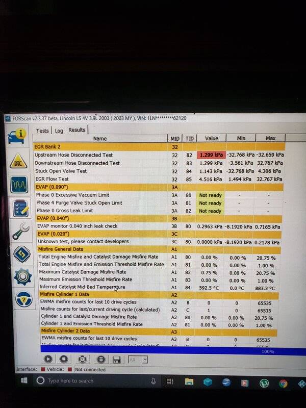

Thanks guys, but I kinda hijacked this thread with a question about forscan, I believe the original poster still has his issue also.

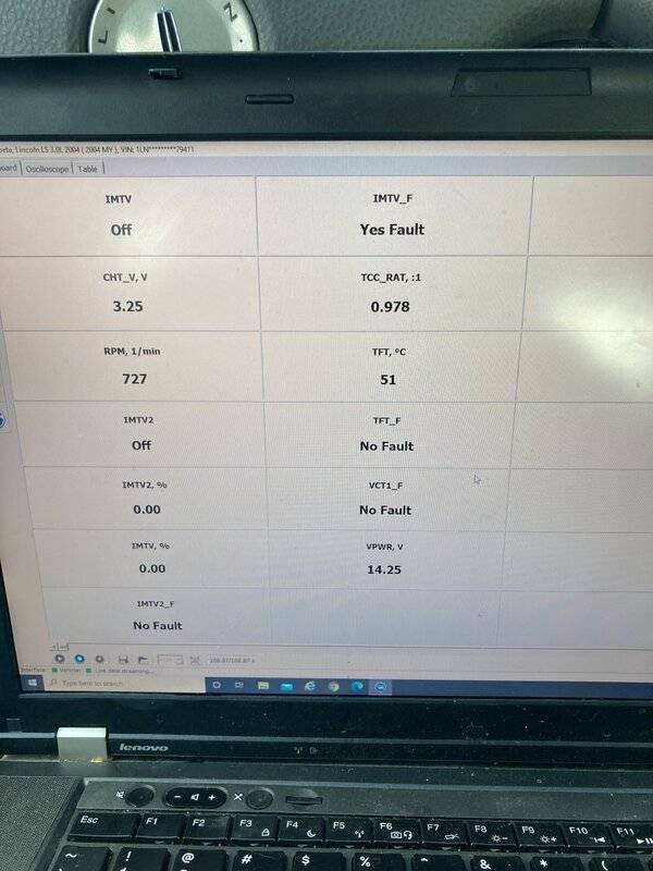

just giving a brief update. I ended up clearing all the codes and noticed my P0660 code is still showing, indicating an IMTV circuit fault. I ordered a IMTV valve and IMTV O-ring for the non faulty one. I figured I might as well change the O-ring on the one that isn’t broken.
Went on a drive using Forscan data tables. They indicated I have an IMTV fault on one of the valves. That’s what led me down this path.

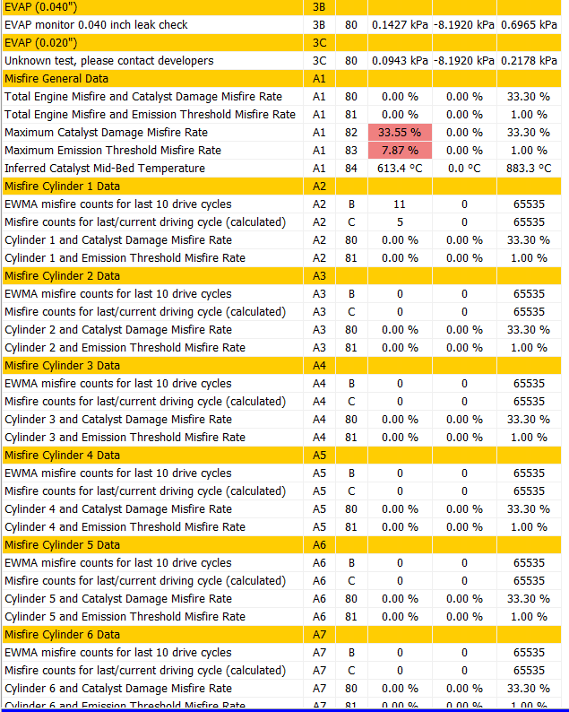

I purchased a new imtv and O-ring to replace on the other imtv and after removing the cabin filter assembly and enclosure I found that one of the imtv’s was unplugged. I guess when I paid someone to do my valve covers awhile back the must’ve forgot to plug one of the imtvs in. Error code went away. This however did not fix the misfire issue. Beginning to think it’s time to replace the coils although I have no codes.
