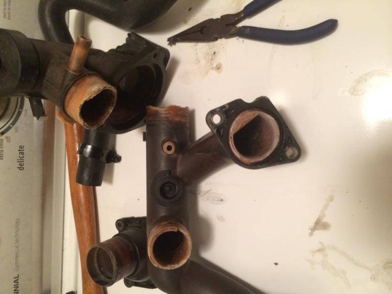

FACT: Even in this special world of yours, as much as you wish to deny it or thumb your nose at the situation, your insides of your plastic cooling parts are beginning to look like the following:
At the very least, if not at this stage just yet, it will have signs of brown little pitting marks, which are the beginning of the deterioration process. Over the years, after an overwhelming amount of heat cycling, that's just what this plastic does. Yours is no exception to the FACT. I understand from your posts that you do not think so but you are seriously delusional if you think the inside of your plastic cooling system parts are near brand new since the day it rolled out the WIXOM plant.
