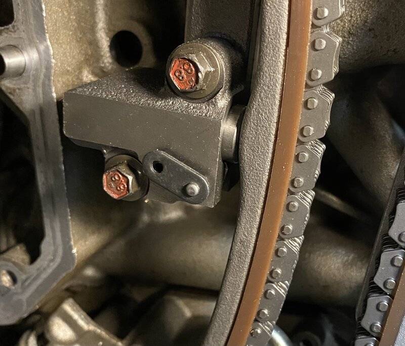

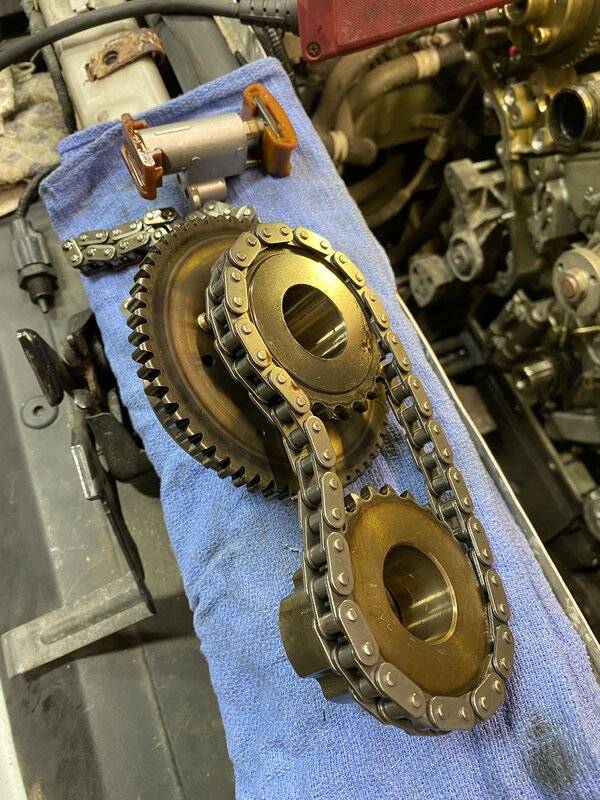

Upper left you see the old tensioner IMG 2519
IMG 2693 you see a new one installed from the back side.
The silver bar is a tool to hold cams from turning.
The Bicycle-looking thing is a lever that operates the pawl to
release the plunger.

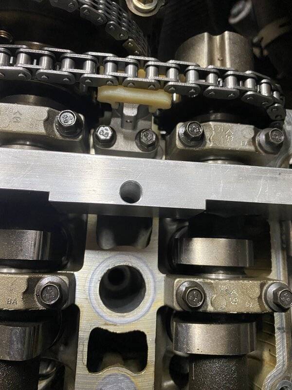

The Cam Sprockets Have NO Keyways...
That is why it is important to Have the tools to PIN the Flywheel with the NO.1 cylinder @ TDC
And the Bridge Bar to hold cams from turning. This is only necessary if you unbolt the sprockets from the Cams. I had a toolmaker make me another Bridge so I
didn't have to flop sides. The bar lays on and bolts down on the Flats on the cam so they can't turn.
You will not need to do this if only change the upper tensioner.

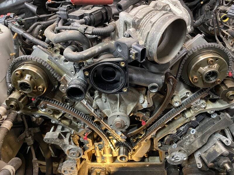

I broke the bolt the... Old Timers Way (Pre Over Head Cams) by putting a socket and a breaker bar on the bolt and hitting the starter. It made an awful loud crack when it broke loose. So my guess is all the slack went out of the chains and the tensioners pushed out and locked the chain tight! I still may be wrong about all this, only time will tell for sure! All I know for sure is that... the chains were very tight, especially the P/S
Nope... you are not wrong. Next time use a "right angle impact wrench" to loosen and remove the balancer.
Using "old school" methods on newer technology can be expensive. (obviously)
