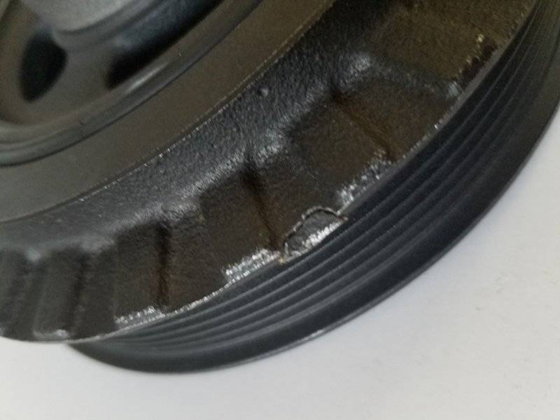

Got the last OEM harmonic balancer and it came damaged in shipping... Complaining to ebay, but worst case scenario, can this be repaired and used?
It has to be smooth everywhere that the belt touches, or the belt will quickly be damaged. It also has to be well balanced.

Yes, it was very poorly packed with the edges touching the side of the box and there were tears in the box from the edges of the balancer. My thinking is if I can get a refund, try to smooth or weld the part back together so it isn't eating up my belt. I called my dealer and they said they couldn't get the part anymore, where did you find them for $889? (not that I'm going to pay that lol)
