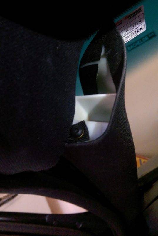

Curtain airbags are in the headliner. The A pillars are the same with or without side curtains.
once a guy here PM'ed me about the clip that held it on on an 06 with side curtains, said once he removed both panels that they would not clip back in, also said the dealer told him that they are a one time only kind of thing and made him buy new A pillars. I haven't seen any that didn't go back on (as long as they were taken off correctly) so I didn't know for sure.
That's just upsetting. It was probably just difficulty aligning it combined with worn push clips not securely clipping
I have side curtains in my 06. I've had the A pillars out and back in a few times. It was no different than my 04 (without side curtains). That was BS from that dealer.

I had a little trouble getting the driver side off on mine. There was an extra fabric strap that attached to the metal retainer clip that the plastic post pushed into the frame. Caused me some headache but got it loose eventually.
[/img]"]
[/URL]
that is interesting, mine does not have that tether strap, maybe he did not disconnect it and pulling it out broke something? (cant imagine anything that couldn't be remedied)

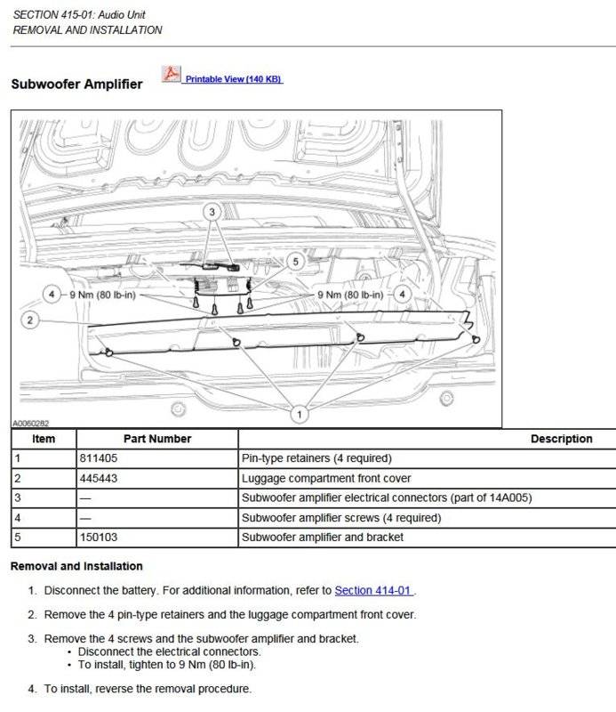

Those two "speakers" on the rear deck are the subs. There's no rule that says subs have to be round or singular (referring to the factory subs). The box between the two is the sub amp.
There are two amps, the sub amp on the rear deck and the 4-channel amp for the door speakers, in the trunk on the driver's side.

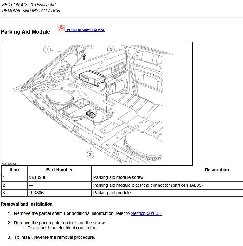

Joe, I do not think that is entirely correct. The sub amp was located on the bottom of the parcel shelf between the subs but was removed before taking the photos. The black box in the photo on top of the parcel shelf between the subs is the reverse parking aid module.

Yes, it is. I didn't look back at the picture he was referencing to see that it was on top of the deck and not under the shelf.
