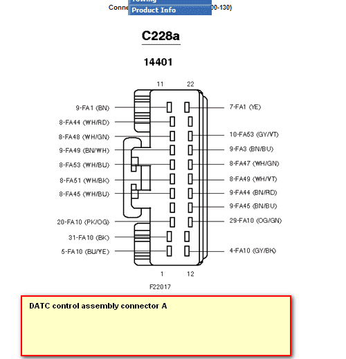

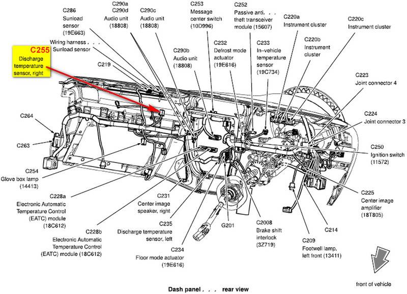

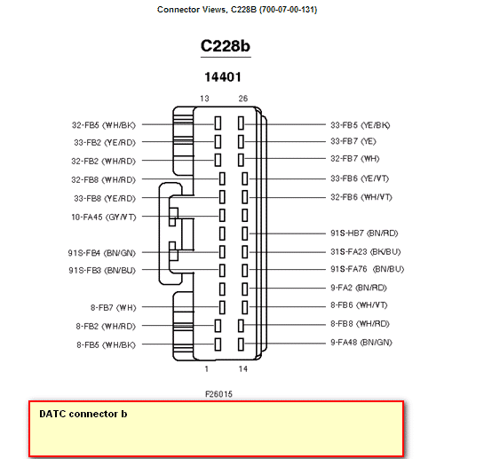

Hey guys, would anyone happen to have a wiring diagram of the climate control system or know which plug is which? I've been having trouble with my a/c and in order to do more diagnostics I need to pull out the datc and check the plugs for resistance and power. I'm pretty sure it isn't the dccv cause it checks out between 10 and 23 ohms like the instructions say and it was replaced last year. I have rechecked it and some other tests and now I'm suspicious that it could be the datc. thanks for your help!
