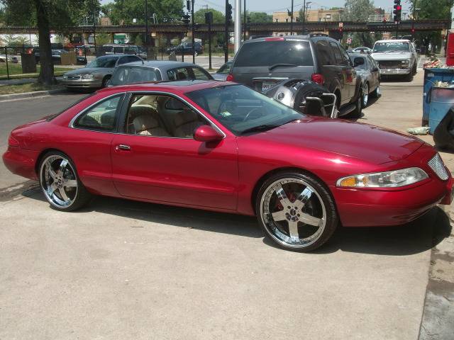

Get a forged wheel, it can built to spec for your car, and are much lighter that a cast wheel of a similar design. Also it takes a lot to crack or bend one, if you do somehow manage to **** one up. you can always go buy another lip as they break down into 2 or 3 pieces, so you dont have to worry about your wheel being discontinued. I have forged 22's and have had no problem with them.
You will need about 35mm up front and 40 to 42mm in the back, depending on tire, it might not clear your rear sway bar.
