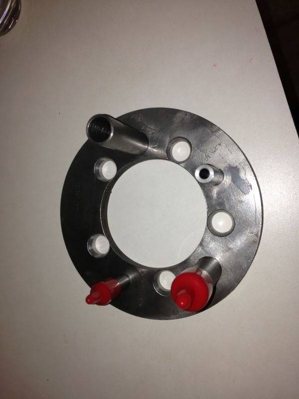

1 - Hub Drill Jig / 1/4" and 39/64" drill bits. Found Here! he also sells on eBay.

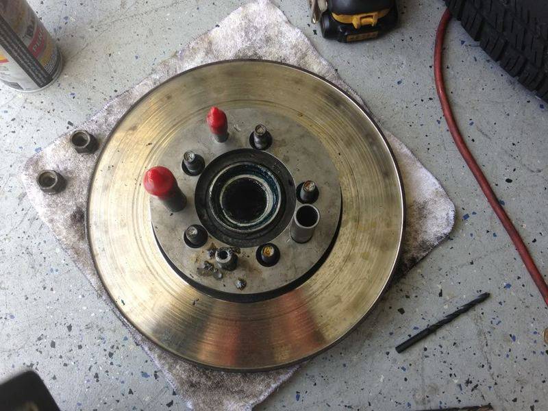

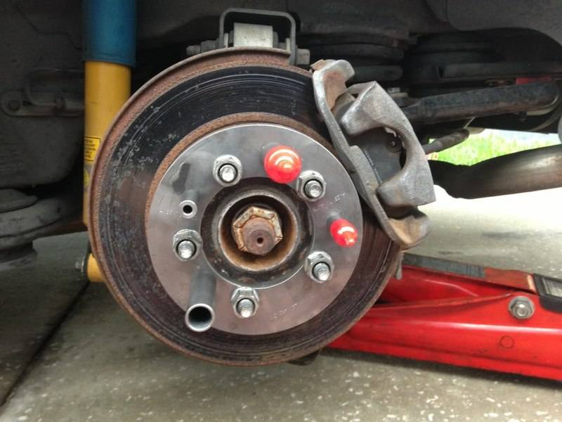

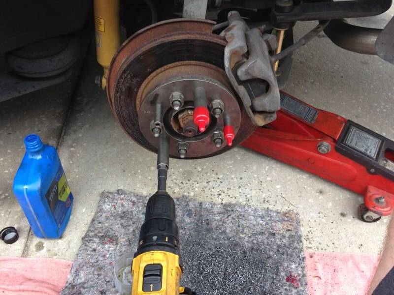

Next is the "work" part. You need to drill 5 1/4" holes, followed by a 39/65" hole. The jig will make sure you drill perfectly square and evenly spaced.
Use a LOT of oil for the drill bit, and slow speed while using a decent amount of pressure on the drill.
Put something under the hub to catch the shavings, there will be A LOT! It does take maybe 10 minutes to do each hole? Maybe less. I had to resharpen my 39/64" bit because it would get chipped up right as I punched thru the hub, so make sure you have a way to sharpen the bits yourself.
You just repeat the same process for the opposite side of the car.

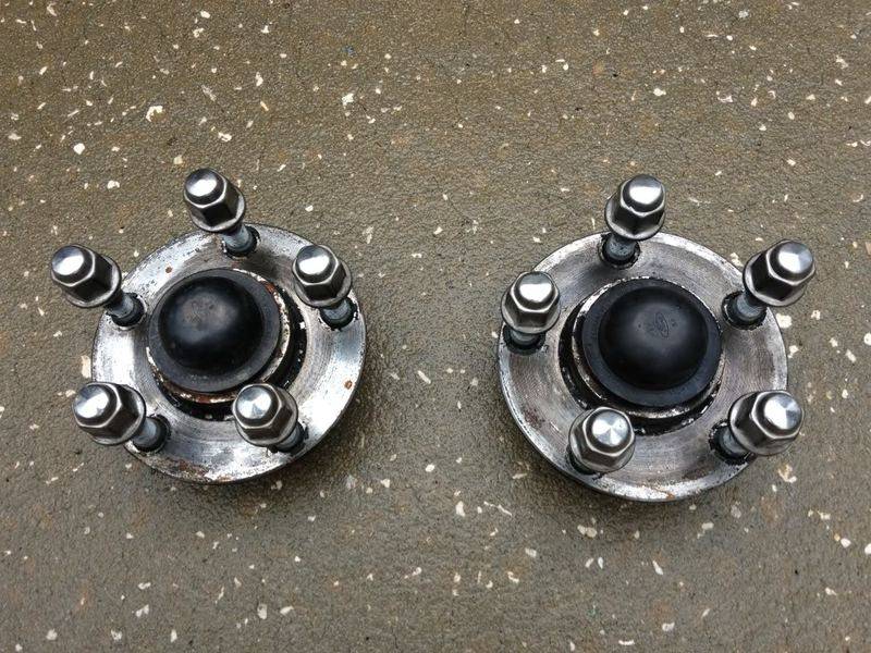

I bought this original OEM pair of Hubs for less than $32 with good dust caps.

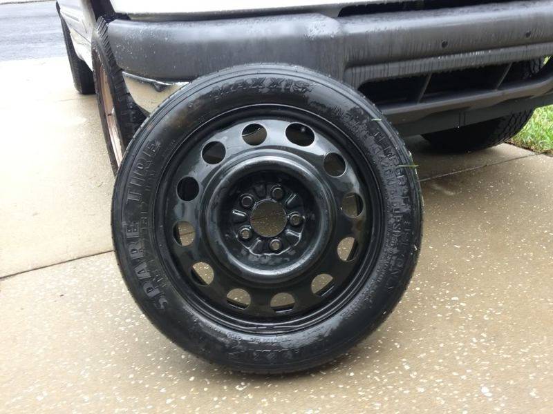

Also, you will want to pick up a 16" or 17" spare from a Mustang, Crown Vic, Town Car, or Gran Marquis with the 4.5" bolt circle. I picked this 17" Mustang Spare at the JY from a 2007 car for $9.

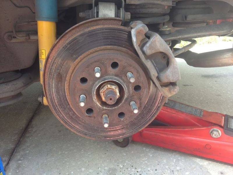

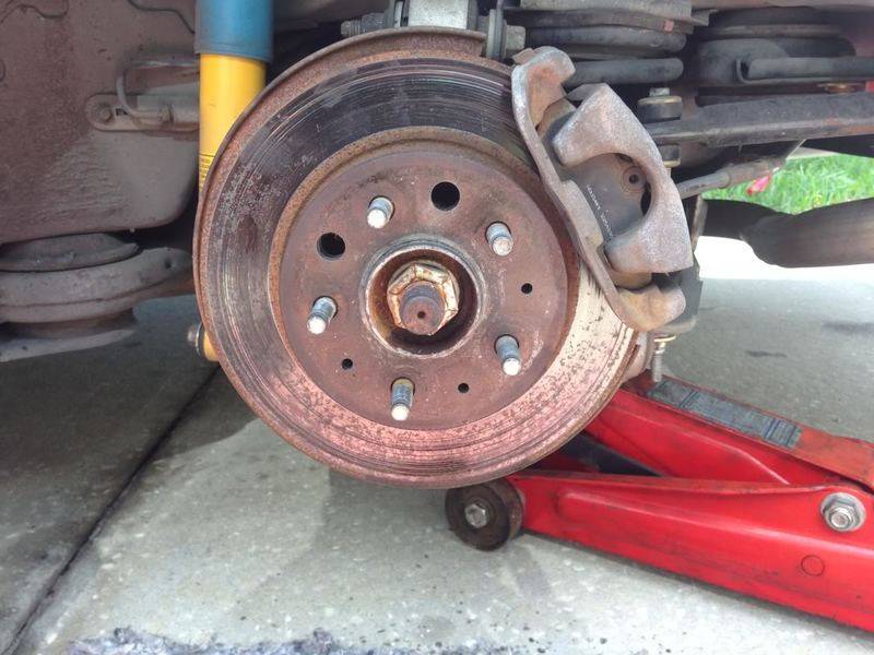

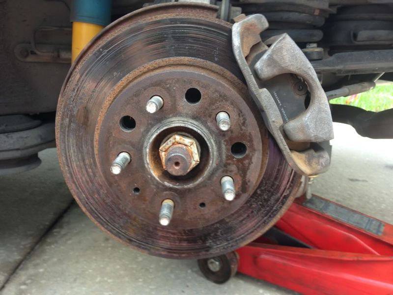

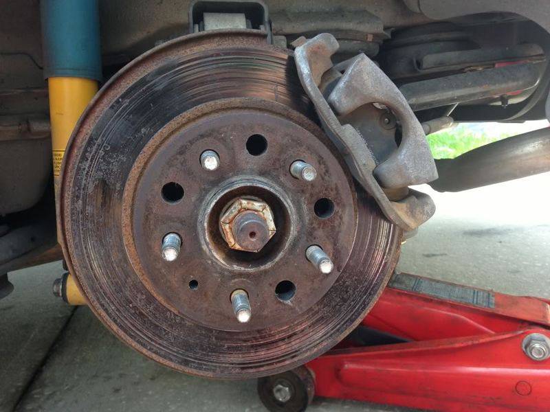

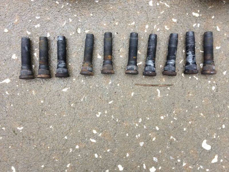

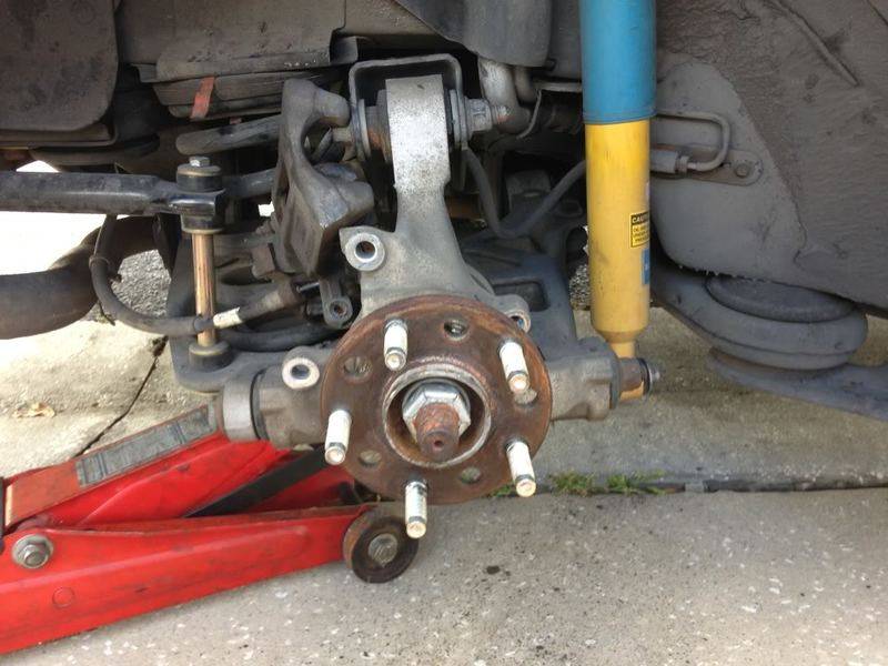

The rear was simple to swap once the new holes were drilled with the jig. You just remove the rear brake caliper and rotor. I chose to remove my dust shields, but you can leave them on. Then, smack your studs with a hammer (and punch) to knock them out the back side. They take a bit of wiggling, but they will come out.
Pic taken after knocking out my old studs.

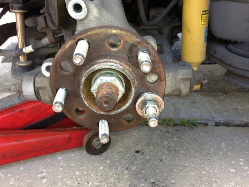

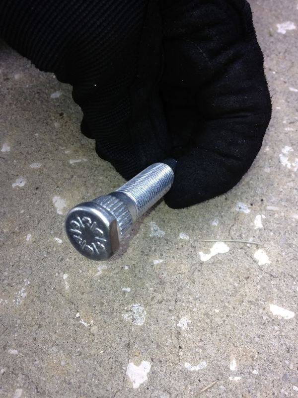

I ground a small flat on the studs, just so that they cleared the knuckle a tiny bit better.
I used a nut, 3 washers and grease to pull the studs into the hub. Did not take too much effort, my 3/8" DeWalt had enough grunt to pull them almost all the way thru, some required use of a ratchet to finish pulling them in.
All installed...

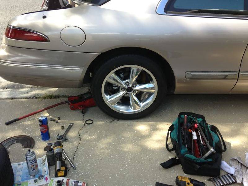

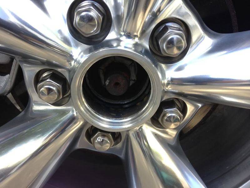

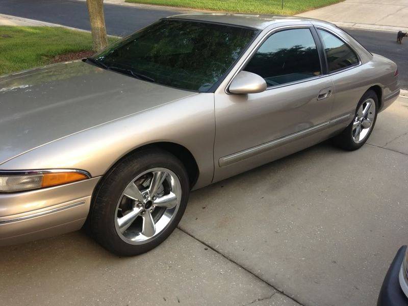

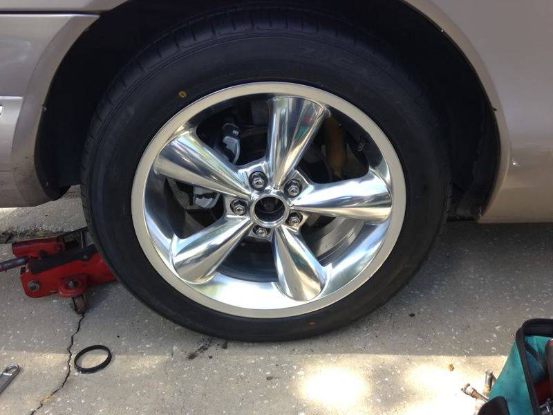

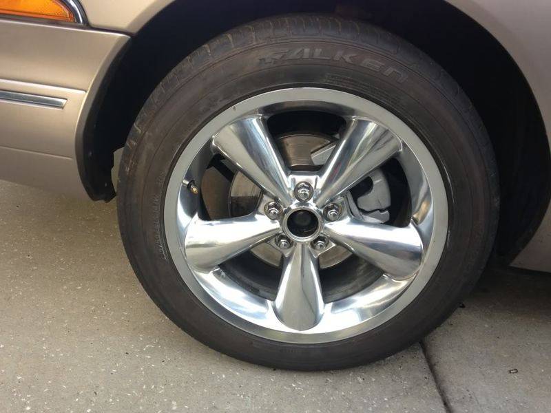

Wheels installed with my hub-centric rings
18" x 8.5 50mm offset

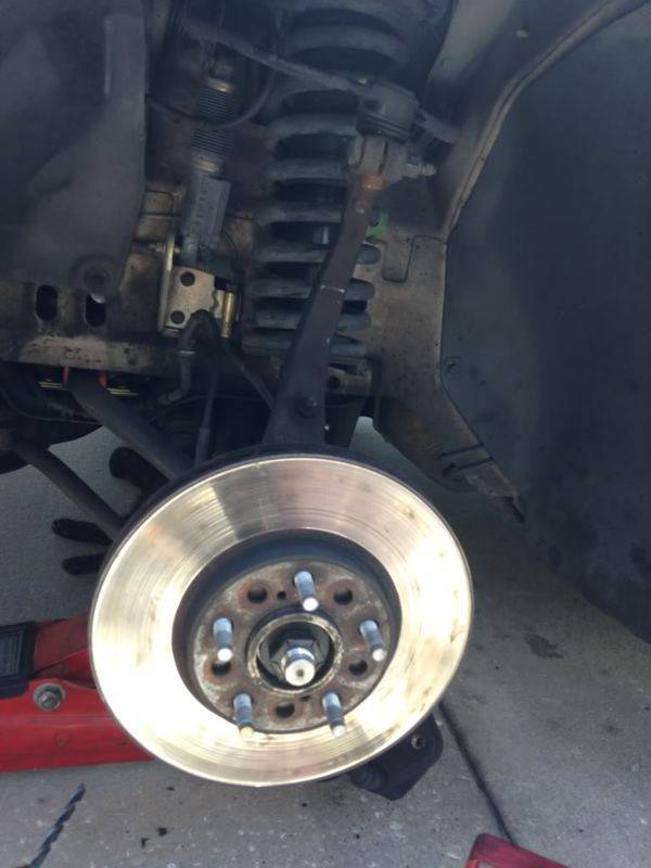

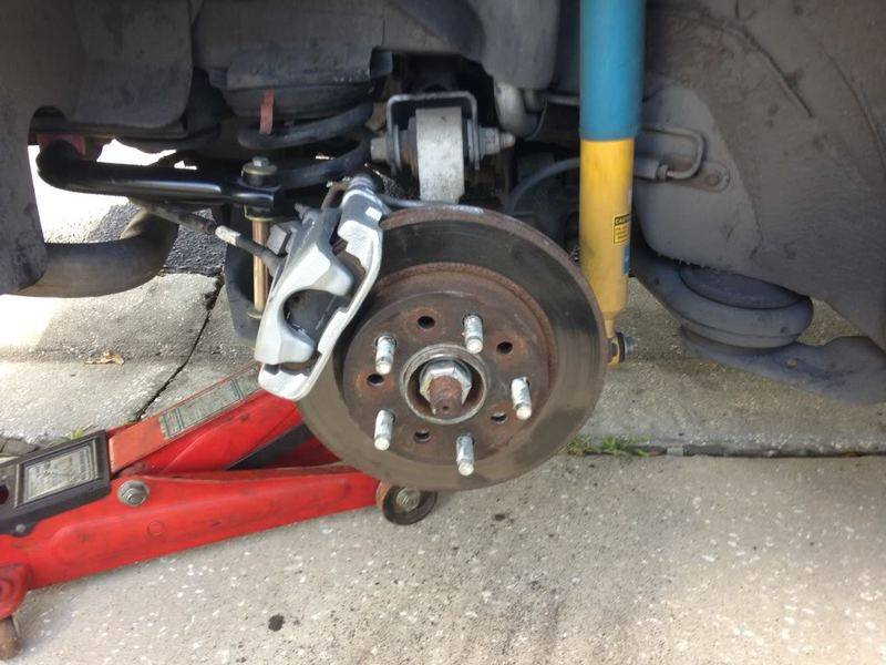

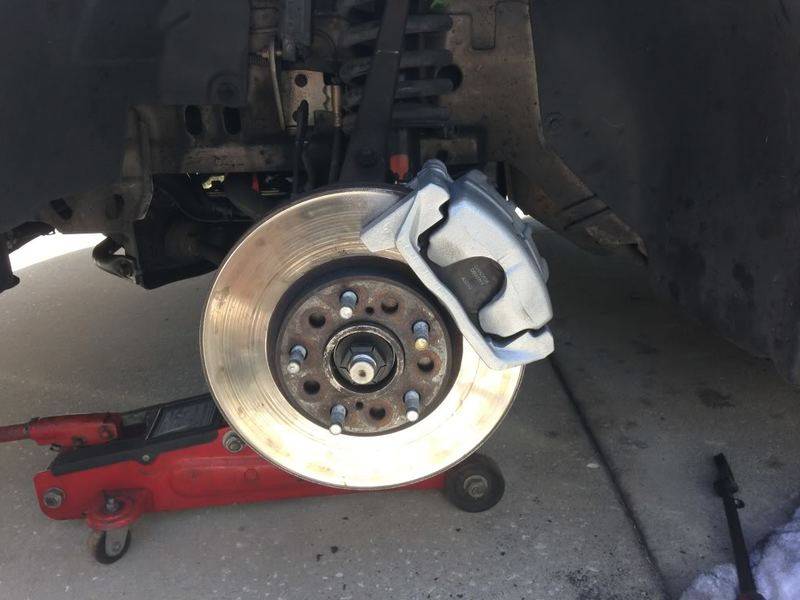

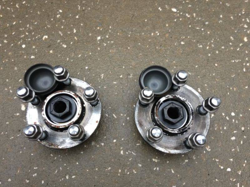

Now for the fronts. The fronts are much simpler. The only "hard" part is drilling the front rotors if you are keeping the stock brakes.
Start by removing your wheel and caliper/rotor.
Next you will need to remove the front dust cover. I used a small pry bar and a hammer to get them out enough to pry them out. Next, remove your stock hubs and set them aside. Slide the Mustang hubs on and relighting the 36mm hub nut. Then install the dust cover with a mallet, I prefer to hit the flat on the front to seat it evenly.

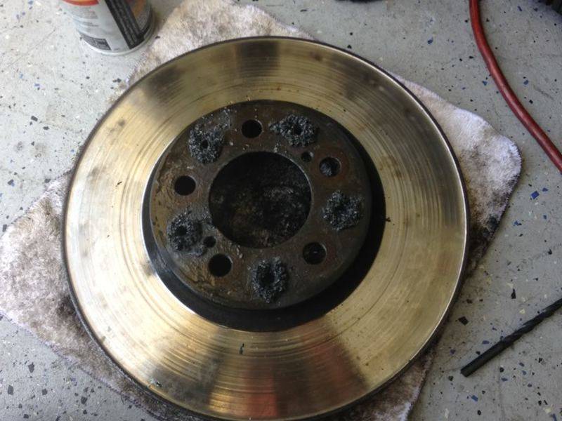

Rotors drilled to 4.50", again using the hub jig and the original hub. Drilling them like this is much better than on the car.
Then install your new wheels, after tightening down the caliper.
